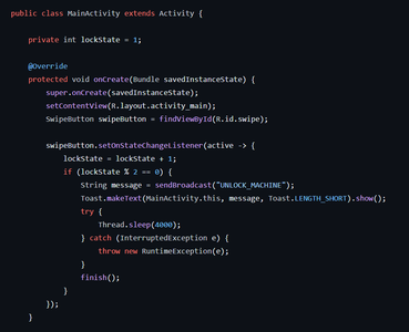

Step 3: Main Activity Class
As you can see we have our main Activity class extending Activity that will bring us the inherit oncreate method to let us set the basic configurations. Among the basic configurations, we will set the swipe button id and its main change listener. Bear in mind that you will have to implement the swipe button library and of course, have ready the main activity layout with swipe object configuration.
Going back to our swipe button listener we will set the base logic to change the button state by using the lockstate variable, adding one to it, and checking if it's even by the modulo operator. By doing this we can detect when the button was swiped, once we detect that, we call the sendBroadcast method with the message to be broadcasted.

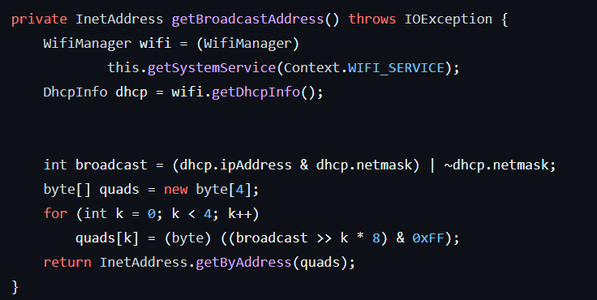

Step 4: Send Broadcast Method
Now, this method has all the necessary instructions to prepare and send the incoming string parameter as a broadcast message. That basically means that will send the message to the network. This method has an auxiliary method that basically returns the network address of our local network dynamically. This will let us execute this program in all networks we are connected with; without having to put/modify the actual address. And will let us use this app on different networks. Once the method sendBroadcast gets the local network it will send the packet built by the actual message, the length, the address, and the port, which by now will be fixed to this number, which of course you can change. Once the packet is sent successfully, another message will be constructed and returned as a method return also we will be logging that message.

Going back to the oncreatemethod, the return of the sendbradcast method will return that message and print it to the device screen as a toast. We will set to sleep the app for 4 seconds to show that message and finally call the inherit finish method to close the activity and let it start again in future log-ins.
