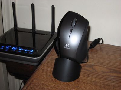

Introduction: Logitech MX-Revolution Charging Base Accent Lighting
This tutorial will explain to you how to easily add accent lighting to your Logitech MX Revolution charging dock.

Step 1: Getting to the Guts
You will be working with soldering irons on an electrical device. It is a possibility to ruin the dock or burn yourself. If you do not know how to solder, learn first.
To start:
You will need to cut into the label on the bottom of the dock to find the 3 hidden screws.
Once the screws are removed, open up the dock. Inside the dock you will see two more screws, remove them.
The next part is a bit tricky. You will have to push in the two metal contacts on the top of the dock while you pull down the board on the inside.

Step 2: Soldering the Guts
Once you have the guts out, you will see where the power wire is connected. Obviously the wire with the white stripe is positive.
Take out your multi-meter, set it to dc volts and measure. (I got 7.9v at .25ma)
The particular LEDs that I used were salvaged from something long ago, but if you use the 9v 1ohm resistor trick with your multimeter you can determine the current of your leds.
Take the numbers that you got, and plug them into a led resistor calculator to determine what size resistor you need. (As i finished this project before I wrote the tutorial I do not remember what size resistor i used.. use this great resistor calculator)
http://ourworld.compuserve.com/homepages/Bill_Bowden/led.htm
Wire the two leds in parallel (they must be the same. if you salvaged 1 led, use only 1, dont try to mix them up, if you salvaged two leds from the same item, that will be fine)
On the bottom cover, there are some silver weights. drill one hole (use a bit with the diameter of the led) in the middle of the weights, and then drill another one in the center of the two rear screw holes.
I managed to use flat leds, but if you have one with a large clear... im not really sure what its called.. the plastic on the top of the led, you will want to grind it flat with a rotory tool.
