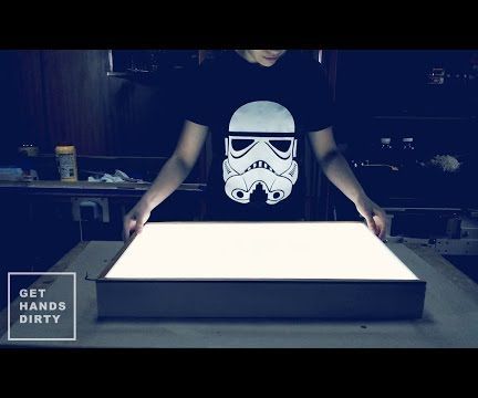

For this project I'm going to use MDF painted black and the light box is going to be hang on an indoor wall, so there was no reason for me to spend extra money on any other material.
I used 3/4" (19mm) MDF for the box frame and 1/8" (3mm) MDF sheet for the front panel with the carved letters as also for the backer board.
Other than that, I used 1/8" (3mm) while opaline acrylic sheet (translucent), aluminium tape, a little bit of epoxy glue,an LED strip (I used just a bit over 13 feet (4m) with a power supply, some electrical wire, basic soldering equipment and also a switch (optional).
First of all, we need to cut our MDF in strips to make the frame. My logo final size is 21" x 21" x 2" (55 x 55 x 5,3 cm) which means that I cut the strips about 2" wide. I went with glued miter joints and screws for reinforcement but you can use any other type of joint that you feel comfortable making. Or you can just butt joint the pieces with countersink screws but don't forget that if you are working with a square logo, so 2 of the sides need to be smaller:
x - (material thickness x2) = dimension of the 2 smaller sides.
I also made two rabbets with a rabbeting router bit on both sides: one for the backer board and one for the acrylic sheet. This one should be just the perfect size so that the acrylic doesn't wobble too much - in this case, 1/8" (3mm) deep. This last rabbet will trap the acrylic sheet in place.

While we wait for the wood glue to dry, we have some time to cover the backer board with aluminium foil and tape so that the interior of the box gets as reflective as it can. This is a really cheap and efficient way to make it.

Next step is applying the LED strip all around on the inside as also on the backer board in zig-zag where you know the letters will be just so you end up with a nice consistent lighting and not getting parts less bright than others.
Also, if you decided to use a switch integrated in the box like I did, you will need to make some simple soldering in order to get it working properly and also connect all the LED strip pieces.
Make sure ir works before closing the box!
