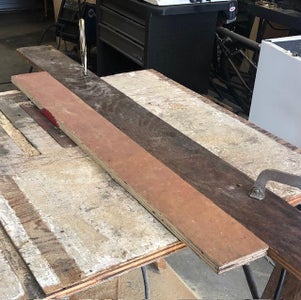

I used some plywood for the level body that I pulled from a scrap pile and had planned to use it for shelving. My homemade tablesaw uses a rip fence four feet long. If I rip something a couple of times I can remove very little material, but also flip it to remove irregularities. The resulting piece is very straight. I decided to make my level 60 inches long.

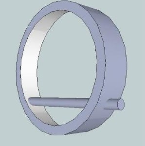

The first image was produced in Google Sketch-up. The proportions are not exact. I used a sketch rather than a photo because the exact outcome of this project was still very fluid in its early stages and I did not regularly take photos.. The pipe collar is black iron pipe a tiny bit over 1 7/8 inch in actual diameter. The holesaw I used is exactly 1 7/8 inches. The pipe collars can be turned down on a lathe, or they can be ground on a wheel by hand to fit.
I had to mount the vials lower than center because their length is considerably shorter than the internal diameter of the pipe. Drilling a 3/8 inch hole across a pipe collar like this is prone to skating by the tip of the drill. I started with small diameter holes. As I proceeded I kept trying to aim the hole drilled from one side more directly at the hole drilled from the other side. A rattail file and a reamer helped to transition to the aiming point I needed without the drill skating.

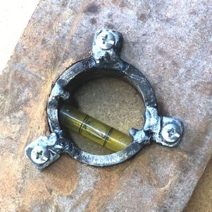

I did use a 3/8 inch steel rod to check for alignment of the holes, as you see in the Sketch-up drawing. The second image shows sawing the pipe to make a collar the width of the level body. The third photo shows steel mounting tabs I welded onto the pipe collars for mounting to the level body. I also drilled a hole in each tab for a mounting screw. You may notice pieces of 1/8 inch rod that cross over the top of the level vial in the third photo. They are welded in place and insure that the vial does not come out of its mounting holes.

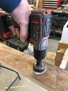

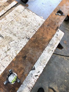

Use a holesaw to make two holes in the body for the vials and their mounts. (First photo) They can be positioned wherever you want them to be. I chose to mount the one indicating horizontal level equidistant from both ends. I mounted the other indicating plumb near to one end of the level body. The holes for the vials and their mounts are equidistant between the two linear edges of the level body. Final fit can be done with a wood rasp that makes the hole a little larger, or by grinding a bit more on the circumference of the pipe.

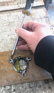

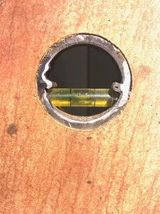

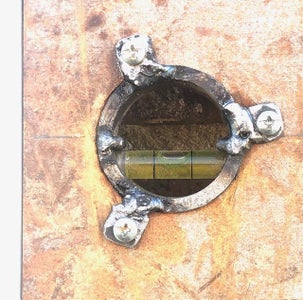

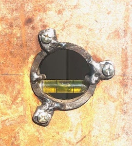

In the second photo I am aligning a level vial for an accurate reading. It is not necessary to use an exactly level surface. It is important that when the level is flipped over (plumb reading) or turned end for end (horizontal level reading) the bubble comes to rest in exactly the same position with respect to the lines on the vial. I held the level to see where the bubble came to rest and compared a flipped reading. Then I used a large screwdriver and a hammer to move the vial mount by tapping with a hammer. It sounds daunting, but it is really quite easy to get a precise adjustment. Several tries and some patience may be necessary. Compare the last two photos on the plumb reading. The third and fourth photos show readings from the same vial when the level is flipped vertical edge to vertical edge. Notice how the bubble is positioned equally between the index lines. The level is well-calibrated for this vial.
