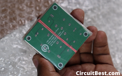

Inside 5 days I got My PCBs. here you can see the quality it is extraordinary. At that point, I Gahererd all the segments. I Placed the parts on the PCB. Presently I Used a fine welding Bit. Bound all the parts in the PCB. At that point, I washed the PCB with Thinner.

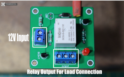

Step 2:
Here you can see 2 Screw terminal Blocks. This 2 Pin Screw Terminal is for 12V Power Supply. Here I am utilizing the 12v Switch mode Power supply. Furthermore, the 3 Pin Screw Terminal is for the Relay Output. The Load which we need to control will be associated here.

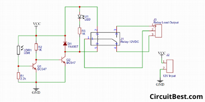

Step 6: Schematics and Overview:
Let me give you a basic diagram of the framework. This circuit depends on basic transistors. Here I have utilized LDR as a Light sensor and a Relay as a switch. The hand-off is an advanced switch that can deal with the greatest current.
On the off chance that the light falls on LDR, at that point the transfer is off. What's more, on the off chance that the LDR is in Dark, at that point the Relay will be on.
Here we will offer light to the LDR through an outer light source, for example, LED. Presently on the off chance that we turn On/Off, the drove, at that point, the Relay will be off/on. The LED takes a limit of 20mA of current So you can utilize any typical wire for controlling the LED.
How does the Long Distance Transmission System Circuit work?
Thus, here are the basic Schematics of the circuit. The LDR and the 2.2k resistor makes a voltage divider. From the outset, assume that the LDR isn't getting light. At that point, the resistance of the LDR will be boundless. In this way, not current will spill out of Q1 Transistor. This time current streams from Vcc to Q2 Transistor's Base through 1k Resistor. It Activates the Q2 Transistor. The Load which is associated with the Q2 Transistor will be controlled up.
Contrarily, on the off chance that the LDR Gets light, at that point the Q1 became conductive and every single current course through the briefest way that is VCC to GND 1k Resistor. No present will stream into the Q2 Transistor's Base. In this way, It won't trigger the Q2 Transistor just as the Relay.
