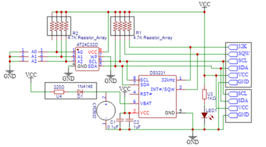

  • DS3231, real time clock module

To reduce power, LED1 indicator located directly on module DS3231 should be disabled. Carefully remove diode D1 or its resistor R4. (Circuit diagram for DS3231.) Remove D1 or R4 on module as well. This step disable charging circuit if backup battery is not rechargeable.
