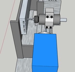

I can already hear some machinist saying to stop wasting your time and rather go and buy a dedicated milling machine. That's not my kind of fun. I like to work out ideas and try to make them work. That's my idea of what a a hobby is.
I have been mulling over different ways to turn my 7x14 Chinese Mini Lathe into a useful Milling Machine without taking up a lot of extra space - something I don't have. I have hunted all over and not been able to find a similar modification or attachment for the mini lathe. All the milling setups I see are very limited in the length of cut they can do. Then I wondered, "Why can't I use the length of the ways rather than the cross slide to carry the main axis for milling?" I then pictured a "milling wall" behind the ways, bolted down to the base of the lathe for rigidity. If you were to clamp a blank for a new milling table to the back "wall" it could even be used to mill out the initial T-slot table of at least 300mm long. Onto the lathe cross slide would be secured a CNC milling head in a vertical milling vise and angle plate (much like one sees on many of the lathe milling add-ons). I like the one that Steve Jordan has made for his Chinese mini lathe which you can see on his YouTube channel.

The new milling wall will need to be very stable and rigid. The distance of the wall away from the back way needs to be set / adjusted so that the cross slide doesn't bump into the milling table. The milling spindle and cutting tool used must extend beyond the length of the cross slide. See the gap I have made in the drawing.
1. The wall needs to be secured well to the base of the lathe
2. A base plate of about 10mm (I think) will be needed to support the lathe bed and the new milling wall.
3. The milling wall should also bolt back into the lathe bed under the ways.
4. The basic wall could probably be welded up from 25mm angle iron with additional cross or vertical bars to support the final T-slot milling table. A solid 10mm steel plate would be better but maybe overkill.
5. When the blank for the T-slot table is fastened to this wall it can be trued up for milling by clamping a dial gauge to the cross slide and sliding along one of the sides.
6. The T-slots can then be milled out as shown in the images using light cuts and lathe's carriage power feed.
7. The new T-slot table can be permanently mounted from the back through the milling wall.
