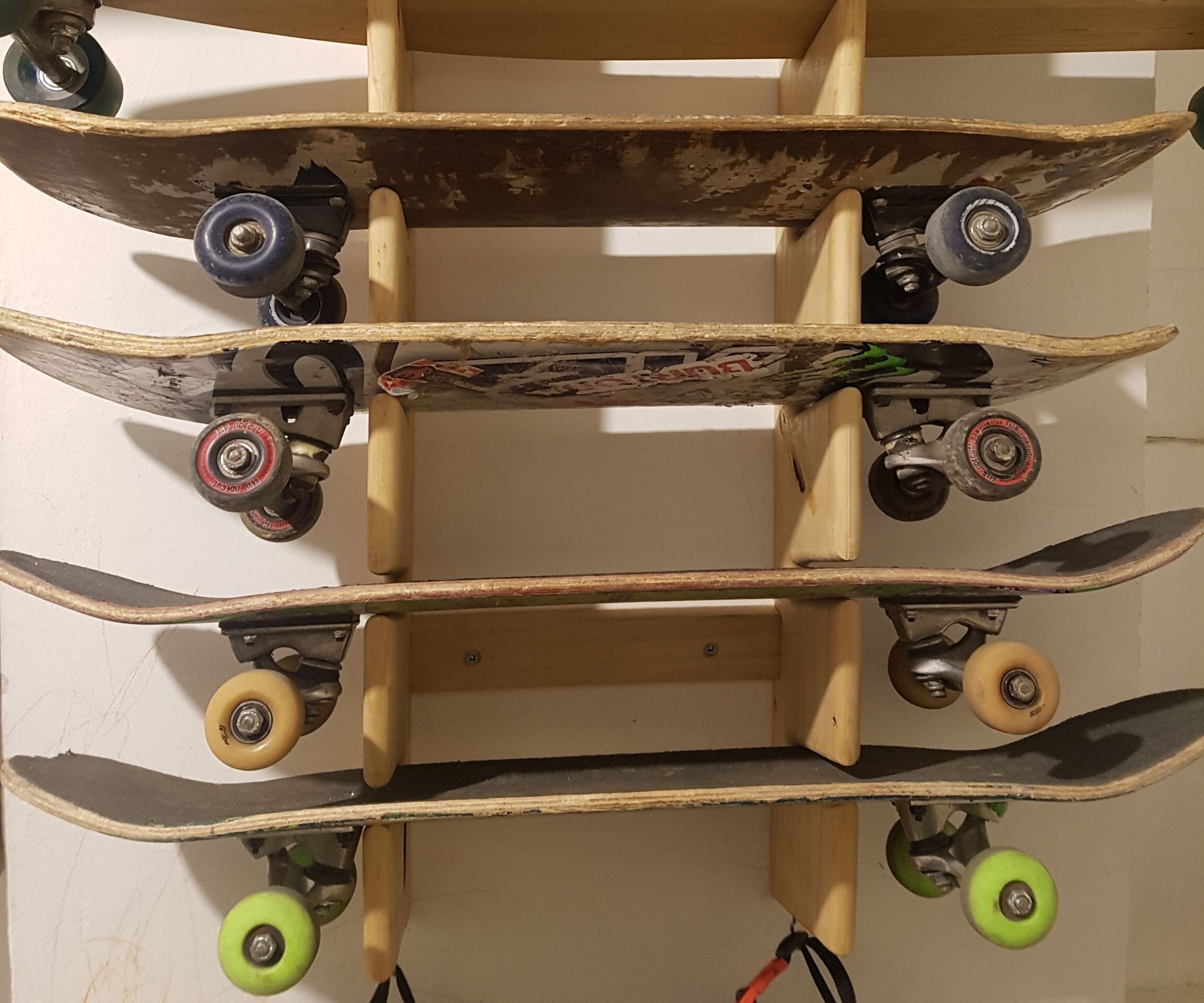

I wanted to find a small project that I can do together with my son he loves to skate and has couple of skate boards but he did not have a longboard. We decided to build one from scrap wood that I had left from other projects. He already had a truck and wheels from older skate board that he did not use any more the only thing we needed to buy was the grip tape.
