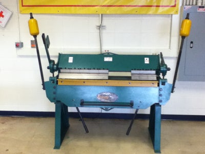

Sheet brake, edge of a workbench. anything to put a sharp bend in your metal

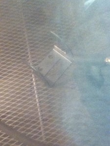

Step 3: Cut the Part

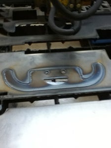

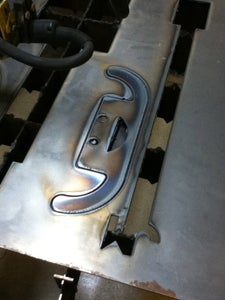

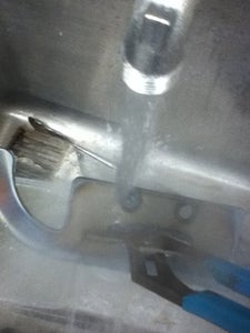

I cut mine out on the plasma cutter, but you can use a bandsaw or a Dremel if you are using aluminum. If you are cutting on a plasma cutter, don't go for it with your hand after it's cut out. It's still REALLY hot. Use a pliers and take it to the sink to sink to do a rinse. Also, watch out for boiling water splashing up all over your hand. It hurts.

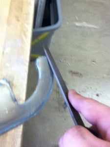

Step 4: Take the Edge Off
Use a file or a grinder to take off the rough edges. If you plasma cut, the edge might be lumpy. Hit these melted lumps off with a rod and a hammer. They should pop off after 1 or 2 hits. Be careful not to bend your part.

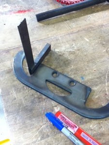

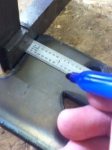

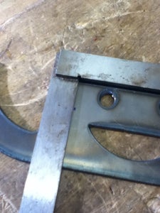

Step 5: Mark and Bend and Finish

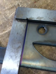

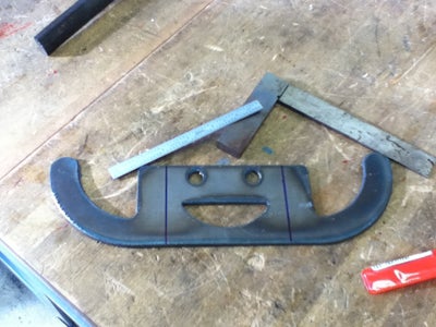

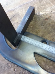

The main body of my part is 6" wide, but I need the bends to be 4" apart. To get the bends perfectly 1" in from each edge, take your marking square and put it up against the edge. Take your ruler and put it up against the square and mark at 1". Take the square and put it sideways so that the long edge is touching the mark you made and draw a line. Do this for both sides. The pictures do a better job of explaining.

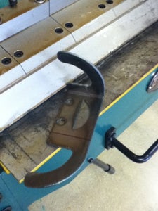

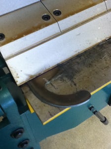

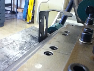

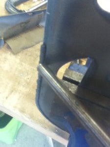

Once you have the marks, take it to the sheet brake or the edge of your work bench and mark at 90Ë. I just eyeballed and it came out pretty well.

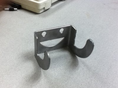

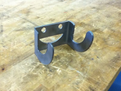

Once your part is bent, you're pretty much done! You can hang it up if you want to, or you can paint it, or sandblast it.
