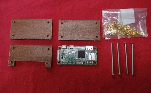

Step 1: Pi Mount Construction & Assembly
I made a mount for my Pi Zero W from some old wooden blind slats I had lying around. I like this design as it makes for a compact construction when you've got other circuit boards to interface to the Pi.
My early attempts used a single slat per layer but I soon found the corners tended to break when assembling onto the screw posts, so I now use PVA wood glue to stick a couple of slats together.
The dimensions of each layer are 70mm x 35mm, 5mm thickness (each slat is 2.5mm thick).
I used M3 screws as these are what I had in stock. Accordingly, I had to widen the mounting holes in the Pi with a 3.5mm drill bit. You could certainly use M2.5 screws and that's what's listed in the parts list.
I used nuts instead of stand-offs, only because I didn't have enough for the job. Using stand-offs makes the construction quicker and it's easier to take things apart if you need to.
I constructed the mount assuming the Pi is on the bottom layer. If it's on the top layer, you can avoid having to cut out a recess for the GPIO pins and thus weakening that layer.
