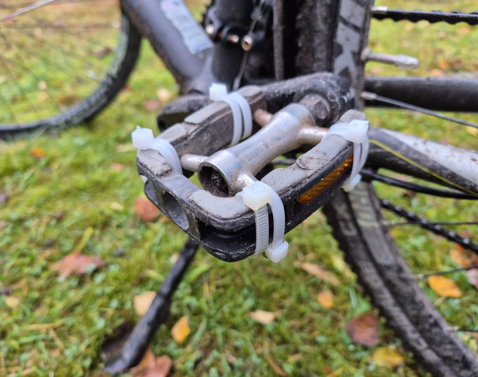

Because my bike is for carrying kids I added handlebars, foot pegs, side basket holder, and later a backrest. I'm planning to also add some clear plastic sheeting to the sides to protect feet from getting into the spokes. The garage hook made a decent rear handle, it was reinforced with metal plates welded on. I threaded the attachment holes on the rack, so the hook can be removed when transporting cargo on the bike.

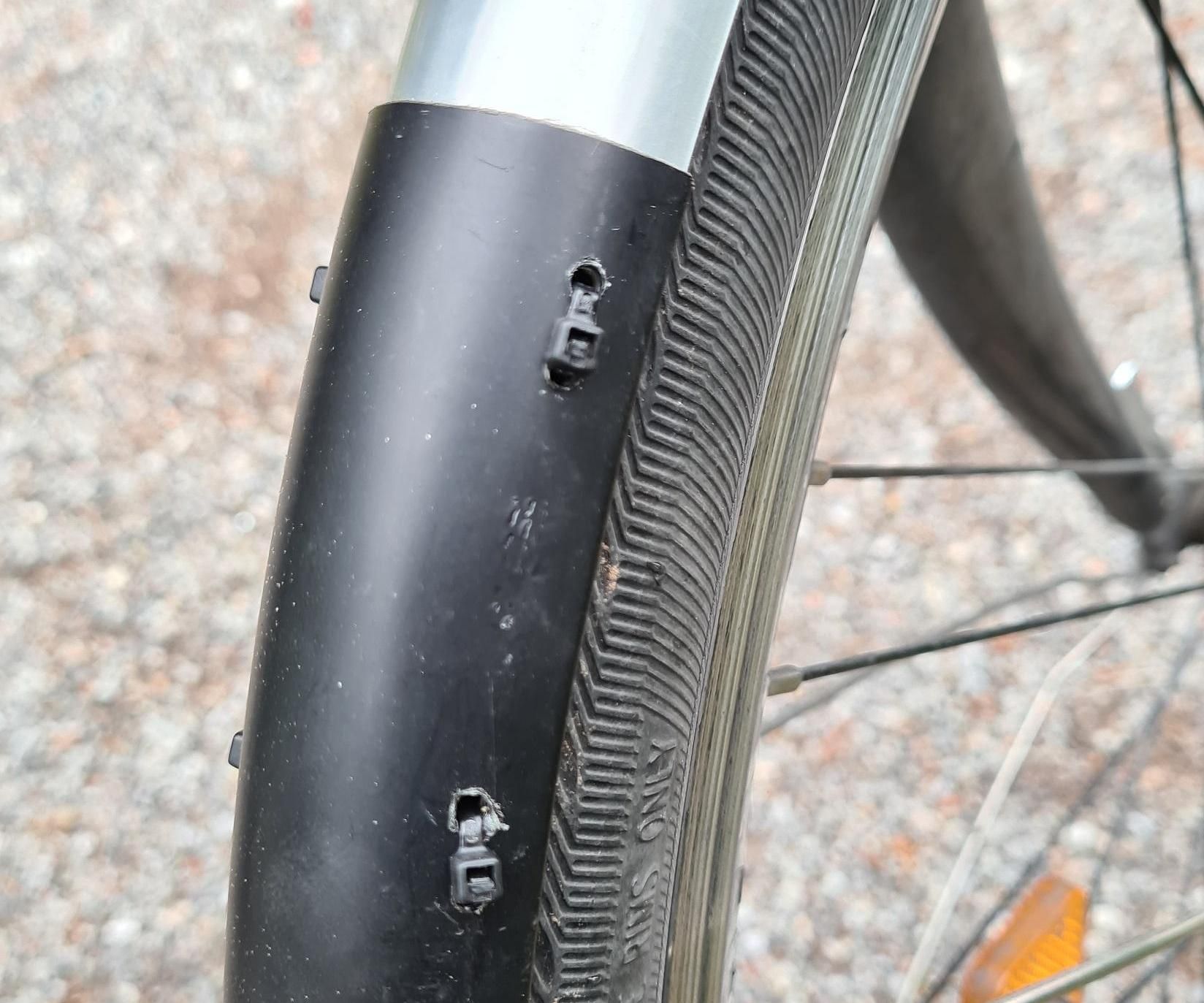

Measure the length and width och your rack and cut a board to size: I took a wooden plank and treated it with teak oil which is fast drying. Attach it with wood screws from underneath, predrill the holes to avoid splitting the wood. The rear fender is attached to the board at its middle, with zip ties in front, an a bolt at the back. The spray guard on the end of the bike is a piece of plastic roofing. I made a steering stabilizer from two springs, mostly for keeping the front wheel straight when the bike is parked or loaded.
