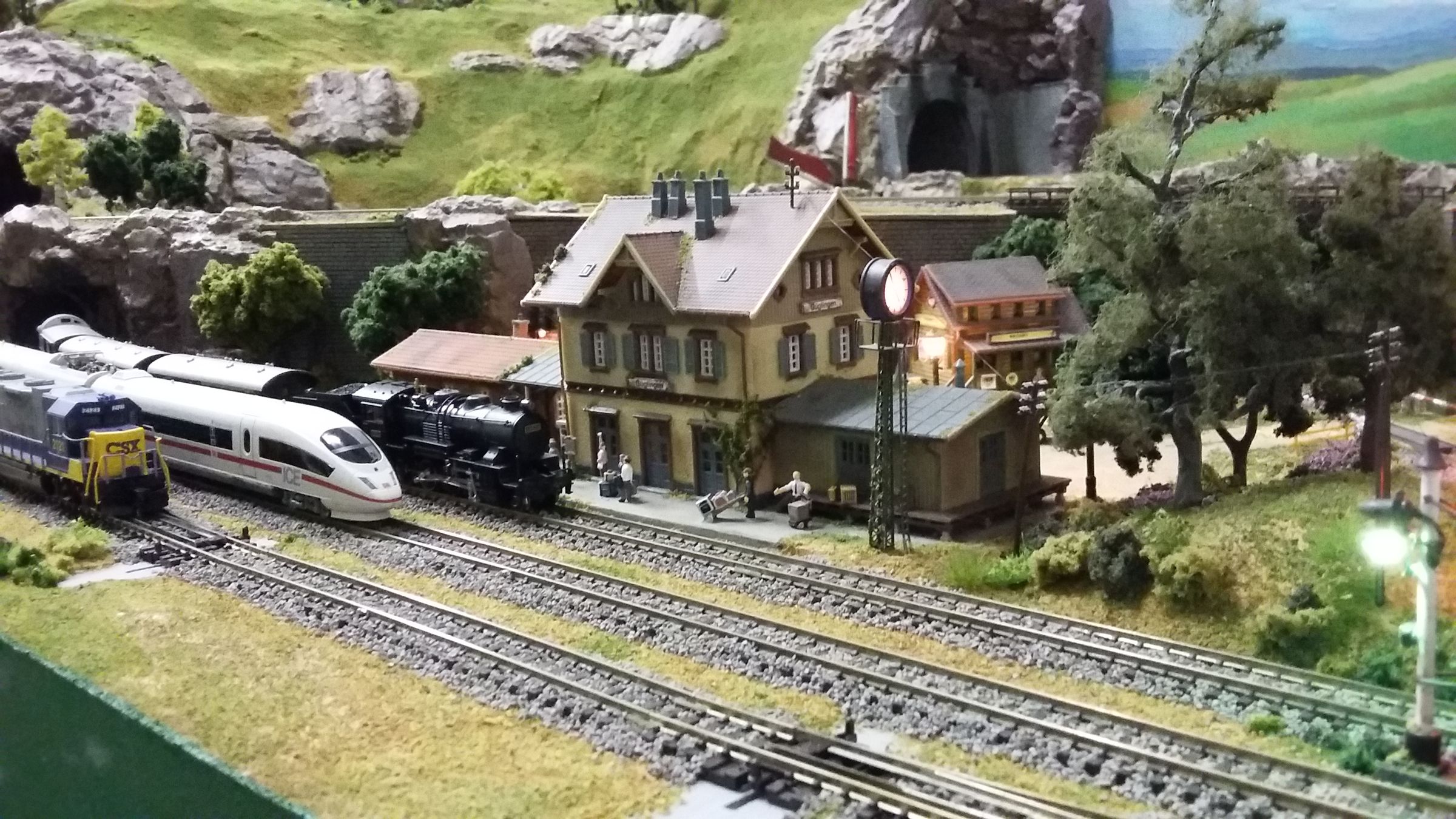

Step 11: Some Awesome Shots of the Layout As It Is Now ...
Here is some close-up shots to show some of the final details on my layout.

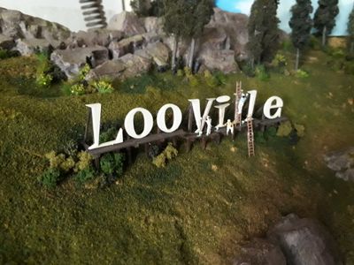

Step 16: Adding the Name to My Model Railroad
Friend and his family came to visit and we were running trains the whole afternoon.
Then his wife turn to me and told me there is something missing on my layout. Mmmmmm.....
The Name !!!!!
What a awesome idea...... I have a mountain so I could do something like the Hollywood name.
My Surname is Loo (Dutch) and everybody know my layout as LooVille,
So I designed the Logo on Sketchup and we lasercut it out of 2.5mm Plywood which I painted.
I then build a structure using square styrene from Evergreen.
I have also bought the Painters from WoodlandScenics to complete the scene.

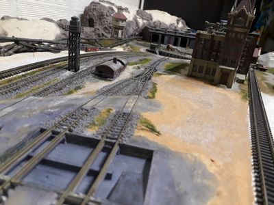

Step 18: The Bench-work for the Yard
Once again I used the 92mm x 20mm Pine. It worked very well and staining it really make it look good.
Yards are very flat, so I decided to glue the Styrofoam on to the bench-work and draw the layout on to the foam.
Building this was much easier as the Town.
Step 19: Start to Lay the Track
Laying the track and the points went very well and it was quick. Really happy with this.
Fitting the Turntable proved to be a challenge. I first cut the hole to big, so had to glue it back and try again. Then there was the track. It is a Fleischmann Turntable, so naturally it had Fleischmann track. I am using Peco code 80. Very different and the two is not compatible. So I chatted to a friend and he told me, pull the track off the turntable and replace it with the Peco. AWESOME idea, loads of work, but well worth it. Turntable fitted and is working well. So now the track laying is carried on....
Step 20: Lying Some More Track....
