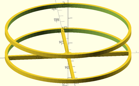

This is the openSCAD script that can be edited to adapt to your petri dish or other type of container.

3D print the support for the filter paper using the STIL file provided in the Supplies section. If you use filters of different sizes then you can modify them.
First, you must create the setup to start the Chromatography as shown in the image above. Get your Petri dish or a box that fits the filter paper perfectly and put the "Base" ring in it first then you can put in your filter paper with the colour of your choice as a dot in the centre. Place the "UppeRing" ring on top. The rings are to provide a gap between the base of the petri dish and the plexiglass circle so they don't affect the results. The plexiglass circle goes next which is just a clear circle the diameter of the filter paper with a hole in the centre to stabilise the pipette.

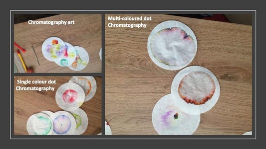

Step 2: Having Fun With Chromotography
Now repeat step 1 with different water solvent pens and see what they are made of. Of course, you don't just need to do one colour at a time you can have a dot made of many different colours and see what effect it does. You can even make abstract art out of Chromatography! Get creative and don't be afraid to try different things.
