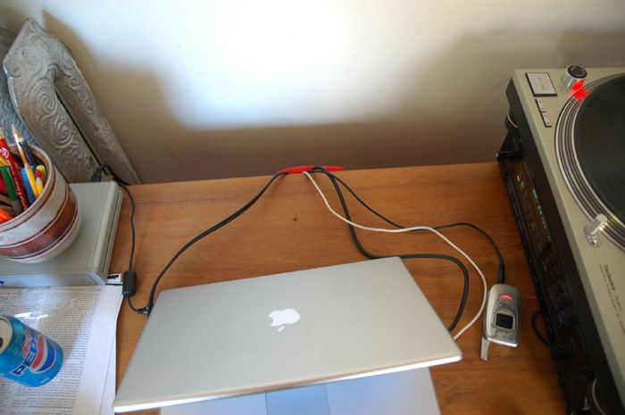

To record, hook up some sort of input device to either jack, hold down the momentary puchbutton switch you either did or didn't wire into SW2, and speak/puch play/press a key/whatever you're doing to make sound. I wired the headphone jack on my laptop to it and play clips of recorded audio. When you're done recording (up to 20 seconds), let go of the button, and flip the toggle switch (after plugging a speaker up to the other jack). It will loop continuously. Some cool percussion loops can be made using this simple method.
