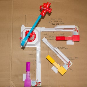

First I took a big piece of cardboard and partially assembled the game on it.
From there I determined where exactly the additional arms should sit to ensure maximum distance from all other arms. Basically a line going from the middle of the center part to the tip of an arm should exist every 45°. The additional arm will be positioned on that line in such a way that its discs will get knocked over exactly at the same point of contact as those of the regular arms.
Marking that position (see picture #2) I can now see just how that adapter I wish to build should look size-wise.
The cardboard plan will come in handy later as well when checking if all is working as it should be.

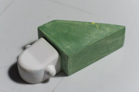

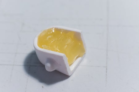

To save myself from some work and to ensure a good fit I used my miniature table saw to cut off the arm holder of the center piece as close to the center piece as possible (read: Use a thin blade). The reason I used a table saw was simply to save time, I could've done this with any handsaw, hacksaw, fretsaw or similar.
A little bit of sandpaper to smooth the cut edge, then it's time to use my hot glue gun to fill the holder up with as mch hot glue as possible. I do this to save on some Green Stuff as I was running out.
Next I use Green Stuff to model the adapter, always checking back with my cardboard dry-assembly if all fits.
I first built it up bigger than necessary, let it dry, then cut it to size with the single edge safety razor blades and/or used the disc sander to grind it down, gave it a runover with sandpaper (120 grit) for good measure and if I was off, build it up again with more Green Stuff and repeated the process.
I wanted the master adapter to be as smooth and well-fitting as reasonably possible. After two days worth of modeling and remodeling I envied those with access to a 3D printer.
Anyway, the result of my efforts can be seen in pictures #3 and #4.

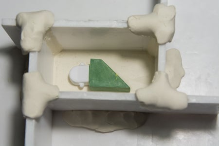

I rolled out modeling clay into a flat surface, then pressed my master adapter in a bit and used a modeling tool to shape the clay up against it to seal any edges and prevent silicone from flowing under it.
For the first mold (picture #2) I used foamboard pieces to make a frame. Again, modeling clay and modeling tools were used to carefully seal any and all edges and gaps, as seen in picture #2.
For the second mold (picture #3) I built a box out of lego pieces and sealed its bottom in the same way as previously.

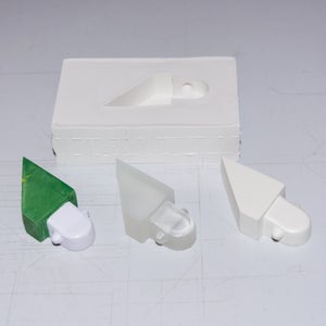

I used a measuring cylinder and water to determine how much resin I was going to need for a cast of the master adapter. Afterwards I dried the mold off and prepared it for resin casting by thoroughly brushing on talcum powder. The talcum powder would ensure an easy deforming later on. I used plastic cups, scale and posicle sticks for mixing according to the instructions, then carefully poured the resin into the mold and let it harden for the three days it required.
After hardening I cut and sanded away any excess resin.
Finally I was done with my first clear copy!
Bonus: Coloring the resin
As I was not very happy with my adapters being clear, for the second center I got myself some coloring for resin and mixed it in with the resin according to its instructions.
Picture #3 shows my second mold (Lego-based frame), my master adapter and a clear and colored resin copy.
