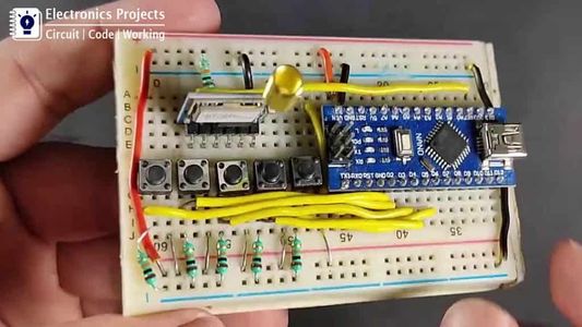

Step 4: Transmitter LoRa Arduino Circuit
In the transmitter Lora circuit, we have connected the transmitter Lora module with Arduino Nano as per the circuit diagram.
In the Transmitter Lora circuit, 5 push buttons are connected with Arduino digital pin D2, D3, D4, D5, D6. Whenever we press any push-button, the signal sent to receiving the Lora module to turn on or off the respective relay.
Here I have made a voltage divider with two resistors 4.7k and 10k to drop down 5v logic level to 3.3v logic level. Arduino can send the signal at 5v logic level but the Lora module RYLR896 can only receive the signal at 3.3v logic level. So we have connected the voltage divider between Arduino TX pin and Lora RYLR896 RX pin.
