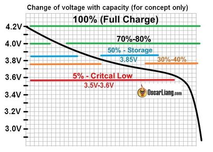

Well first thing first, because i used a lipo battery the operating voltage should be as low as possible. As you can see on the image, the voltage of the lipo will drop. That's a terrible problem ! If the voltage goes to low , the system will stop working. As we get a 2S lipo battery, the voltage show on the graph has to be double. In my case, the voltage have to stay above 3.6*2 = 7.2V .
Then i had to check if the minimum input voltage of the LDO is lower than this limit. In the datasheet, it says the minimum input voltage is at 4.4V. It's great because the LDO wont be limiting factor.

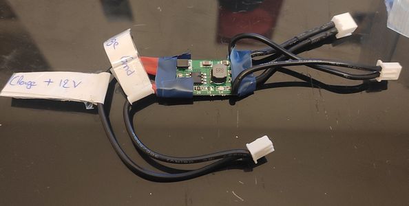

Step 2: Power Management (Application)
Now, let's solder all the alimentation part together !
I used a JST connector to connect the battery to the charge controller, but you should consider to use XT60 instead because the maximum current flow into JST is about 3Amps whereas XT60 is 60Amps.
You can follow the diagram to solder the battery . Be really careful of polarity (i destroyed one controller). On the picture, i have two pack of wire solder on the board because my battery doesn't have 2 pack of wire.

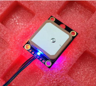

Step 3: Gps
Okay so the main part of this project is a GPS. It is really easy to make it work ! But understand the data isn't.
Just wire every thing together using the documentation show above. Sometimes, after a long journey, the device could take a long time to work correctly. In that case you will have to go outside or put the module next to the windows. It took me 20 minutes to work.
The code i used is not mine , but it is working perfectly to prototype.

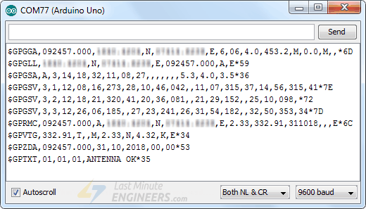

You should get a NMEA frame ! This is a bit complex but we will only focus on the line starting by $GPGGA.
- The first information is a time code (UTC)
- The second one is Latitude
- The third is Longitude
- Then goes something that we wont use
- Then number of satellite
- Then again a non interesting data
- And the altitude

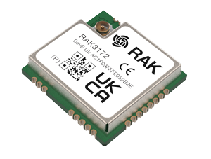

I chose a RAK as Lora emitter because it's quite simple to use and well documented first , but also because it has the Lora WAN stack . This component is based on a stm32 microcontroller and has multiple feature.
I said Lora or Lora Wan , but what is the difference ? The answer is easy to understand : Lora is the technology and Lora wan is the network. Some Lora module are only build to make pear to pear communication (P2P) , whereas other have the ability to connect to gateway and Lora wan network .

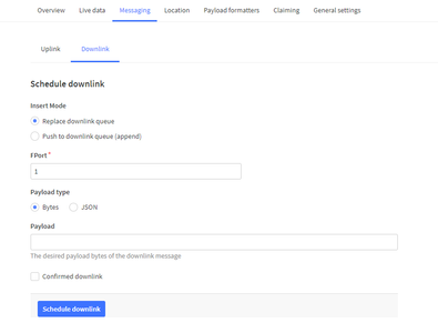

Now, i will show you how to change settings through the Lora network !
First you will have to go into your end device and find this messaging page. Then click on downlink and choose the port number 9. Okay now you just have to enter your command. This command is an hexadecimal command. The first two number are used to choose which settings it will have to change. Then the other are the value to applied to this setting .
For example, here i choose to set the delay between two measurement at 165 min.

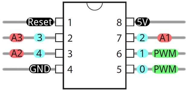

I designed a PCB using Kicad, and i just add a switch to power up the all things. The circuits approximately measure 5cm by 3cm. I only use pcb because the rak is mainly available on special package and have to be solder. If you don't want to use it, you should consider to buy rak breakout board . The circuit is quite simple, it just connect two Uart RX and two Uart TX on a aTtiny85. Pin 3 is used for Transmission to the GPS and Pin 2 for receiving from the GPS . Same thing for the RAK3172 on pin 0 and 1 !
Because we won't use the transmitting line to the GPS, i will delete it on a V2 .
I would like to do a voltage measurement using the CAN of the attiny,but the voltage reference on the attiny is 1.1V or Vref. The problem is that I have only 2 pins left . In my case i will need 3 of them ( 2 for analog measurement and 1 for Vref. So if you have any idea please comment !

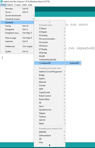

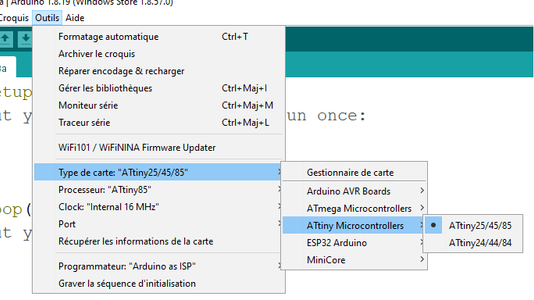

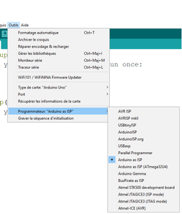

In order to program the µC , i used a ISP programmer. If you don't have any programmer, you can follow this steps. To do it , you will need an Arduino Uno and Arduino Ide.
Start by uploading the ArduinoIsp sketch on your Arduino Uno. Then choose the right programmer, it should be "Arduino as ISP" . Next, you have to Select Attiny85 and an internal 16 Mhz oscillator .
