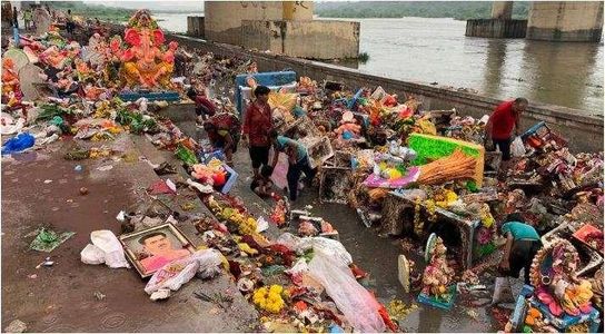

Ganesh Chaturthi is one of the most widely celebrated festivals in India. Families and communities welcome idols of Lord Ganesha into their homes, offer prayers, and after several days of worship, perform visarjan — immersing the idol into water as a ritual farewell.
But while the tradition remains beautiful, the environmental impact has grown severe.

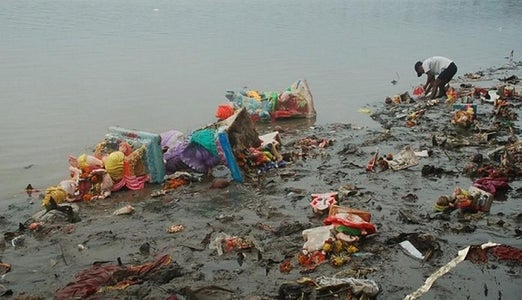

Each year in India, over 1.5 million Ganesha idols are immersed in lakes, rivers, seas, and artificial ponds during the festival. A large number of these are made from Plaster of Paris (POP) and decorated with synthetic chemical paints.
Here’s the problem:
  1. POP doesn’t dissolve easily in water. It can remain intact for months, settling at the bottom of water bodies as sludge.
  2. The paints used often contain heavy metals like lead, mercury, and cadmium, which leach into water and poison aquatic ecosystems.
  3. The result is significant water pollution, destruction of aquatic life, and long-term ecological damage.
To understand the scale:
  1. In Mumbai alone, over 150,000 idols are immersed annually.
  2. In cities like Hyderabad, Pune, and Bengaluru, officials report huge spikes in water toxicity and oxygen depletion after immersion events.
  3. Studies by the Central Pollution Control Board (CPCB) have shown water quality degradation of up to 70% in lakes and rivers immediately following Ganesh Chaturthi.
Even many idols labeled “eco-friendly” are painted with harmful chemicals or contain non-biodegradable decorative materials — leading to the same environmental issues.
I’ve personally witnessed lakes filled with half-dissolved idols, foaming paint residues, and dead fish floating along the edges. This is not a rare sight — it happens every year, across the country.
So the question is:
Can we keep the soul of the celebration alive, while protecting the planet?
This project aims to answer that — by creating a Lord Ganesha idol that’s not only safe for the environment, but also turns into something that gives back to nature.

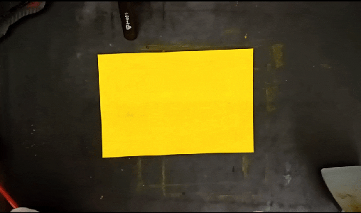

Step 6: Painting the Templates With Natural Colors
Instead of painting the idol after it was built, I chose to paint the template sheets beforehand, right after reinforcing them. I painted the back side of the reinforced sheets — which becomes the outer surface of the idol when it’s assembled.
For this, I used a homemade organic yellow paint made from turmeric. I wanted a soft, subtle finish, and turmeric gave me exactly that — although not without challenges.
  1. The paint job isn’t perfect — partly due to my limited painting skills and partly because turmeric can be uneven to apply.
  2. That said, the slightly textured and imperfect finish adds character to the idol. It gives the piece a raw, handmade personality.
  3. Most importantly, this natural paint is non-toxic, biodegradable, and completely safe for the environment — which aligns with the whole purpose of the project.
To finish this step:
  1. I placed the painted sheets between layers of newspaper and used a cloth iron on low heat.
  2. This helped flatten the sheets and dry them evenly, making them much easier to cut and fold during assembly.
If you're more confident with painting, feel free to experiment with other natural colors like beetroot, spinach, or coffee. But even with a simple turmeric wash, the result is meaningful, effective, and eco-conscious..

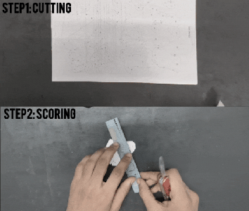

Step 7: Cutting, Scoring, and Folding the Templates
With the reinforced and pre-painted sheets fully dried and flattened, it’s time to begin shaping the individual parts of the idol.
  1. Carefully cut out each piece along the solid lines printed on the template using a sharp precision knife or scissors. For cleaner corners and detailed areas, a craft knife works best.
  2. Once cut, score all the fold lines. This is crucial for achieving neat and accurate folds:
  3. Use the back of a craft knife, a bone folder, or even a ballpoint pen with no ink to lightly press along the fold lines.
  4. Scoring helps weaken the paper at the right places, allowing it to fold crisply without cracking the reinforced surface.
  5. Fold along the scored lines:
  6. - - - - - (dashed lines) = Mountain folds (fold away from you)
  7. -.-.-.-. (dash-dot lines) = Valley folds (fold towards you)
  8. Fold slowly and precisely — a rushed fold can affect the final fit of the model.
⚠️ Tip: Take your time with this step. Accurate cutting and clean folds will make the final assembly far easier and much cleaner in appearance.

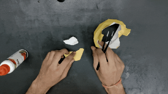

Step 8: Assembling the Ganesh Idol
Once all the pieces are cut and folded, you can start assembling the model.
  1. Match the numbers:
  2. Use the numbers printed on the tabs and edges to match and join the correct pieces easily.reinforced surface.
  3. Apply glue sparingly:
  4. Use a strong, fast-drying glue like PVA white glue or a quality glue stick.
  5. Apply a thin layer on the tabs only
  6. then press the pieces together firmly for a few seconds until they hold.
  7. Work section by section, allowing glue to set briefly before moving on to avoid misalignment.
  8. If needed, use binder clips or small weights to hold parts in place while drying.
  9. Take care with folds and edges to ensure a neat finish.

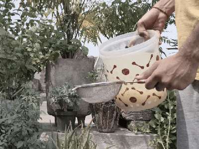

Step 9: Eco-Friendly Visarjan (Immersion)
The traditional ritual of visarjan usually involves immersing the Ganesh idol in rivers or lakes. However, idols made from plaster or toxic paints pollute water bodies and harm aquatic life.
This project takes a different approach:

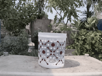

  1. Instead of immersing the idol directly in a water body, immerse it carefully in a bucket or container of water at home.
  2. Let the idol soak and gradually dissolve, turning into soft paper pulp over several hours.
  3. This controlled immersion prevents any pollution and keeps the process eco-friendly.
  4. The paper pulp from this process will be used in the next step — planting.
Step 10: Planting the Pulp to Grow a Living Plant
To complete the eco-conscious journey, the idol is not discarded — it transforms.

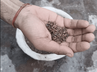

After immersing the paper idol in a bucket of water, I waited until it softened and began breaking down. Once the structure loosened, I extracted the pulp, pressing out the excess water.
In my case, I mixed in a few tulsi (holy basil) seeds — a sacred and native Indian plant known for its healing properties.
You can do the same with neem, marigold, or any locally suitable plant seed.
  1. Form the pulp and seed mixture into a small ball, or
  2. Place the seed-infused pulp directly into a mud pot with some soil.
Keep the pot in a sunny location and water it regularly.
Within days or weeks, depending on your seed and climate, a tiny plant will emerge — growing from the same idol you worshipped.
