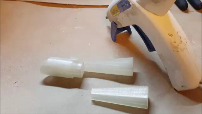

To begin, you want to cut out an almost triangle shaped piece (like in the second photo) from your foam. This will be the pour spout that will allow the molten aluminum to flow into the mold. If your PLA part is wide, cut out a second or third pour spout. Ensure the widest part of the pour spout is quite wide (more-so than mine are in the image above), so your aluminum doesn't harden fast enough.

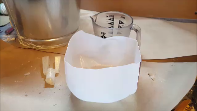

Next you want to hot glue the pour spout to your part, facing up. Then you cut the empty milk jug according to the volume required to completely cover the part, while allowing some of the pour spout to remain above the mixture.
Now it's time to add your mixture:
1:1 Plaster of Paris and play sand
Add about 70% of the amount of Plaster of Paris you used in water
Ensure you don't over or under fill your jug. If you need more, simply add more mixture (keeping the same amount of each).
Begin stirring with your hand until all the lumps are out of your mixture. This part is extremely important, as any lumps can leave bumps in your final cast.
Now take your bag and put it around the milk jug. Ensure none of the mixture falls out. Now take your vacuum cleaner and put the hose inside the opening of the bag. Make sure the milk jug isn't too full, as the mixture can get sucked in the hose, and you don't want that.
Next, using your hand, wrap the bag around the head of your hose and tighten it so no air can escape the bag. Now turn on your vacuum, and it should begin pulling the air out of the bag. Make sure you lift the vacuum hose above the edge of the milk jug, so it sucks the air out of your mixture. Any bubbles can impede on the final cast.
After you've sucked as much air out of the mixture as you can (maybe a minute or two), remove the hose and take the milk jug out of the bag. Now get your PLA part that's attached to the pour spout(s) and submerge the part in the mixture, making sure the pour spout is not fully submerged. Now either hold it here until the mixture is hard enough to hold it by itself or place something on top to hold it in place.
