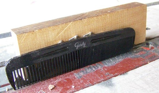

I set the depth on my saw's cut to be just a little more than the height of the comb. I set a tall rip fence.
Step 3: Rip a Slot in the Hardwood
I very carefully used a pusher stick arrangement to cut a slot for the comb. I had to move the fence a little and make a second cut to get the necessary width on the slot.

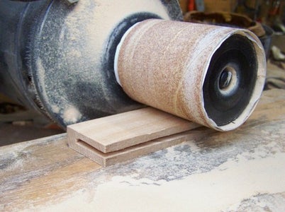

I put the wood in a vise and used a hand plane to reduce the thickness some. Then I used a sanding drum above a small table surface to reduce the thickness and be certain both sides are parallel.
Step 5: Round the Corners and the Edges

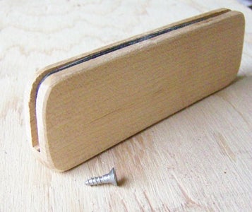

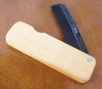

I used the sanding drum to round and shape the wood by hand. The small wood screw will hinge the comb so it folds out like a pocket knife. I drilled a hole through one corner of the comb and used that as a template for locating and drilling a hole in the wood. Then I used a countersink for the screw head.
Step 6: Give It a Test
The comb is mounted in the wooden frame. The countersink has been made for the screw head.

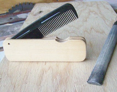

Step 7: Cut Away for Opening the Comb
I made a half-round cutaway so I can grasp and open the comb.

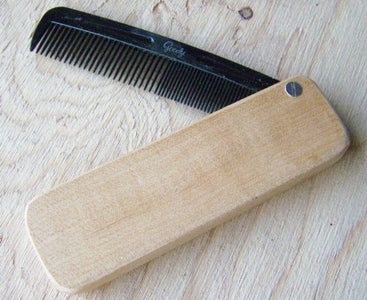

Step 8: Finish
I used a spray shellac to finish the wood. Although it does not show clearly, the finish added a nice golden tone. I should lose far fewer combs now.
