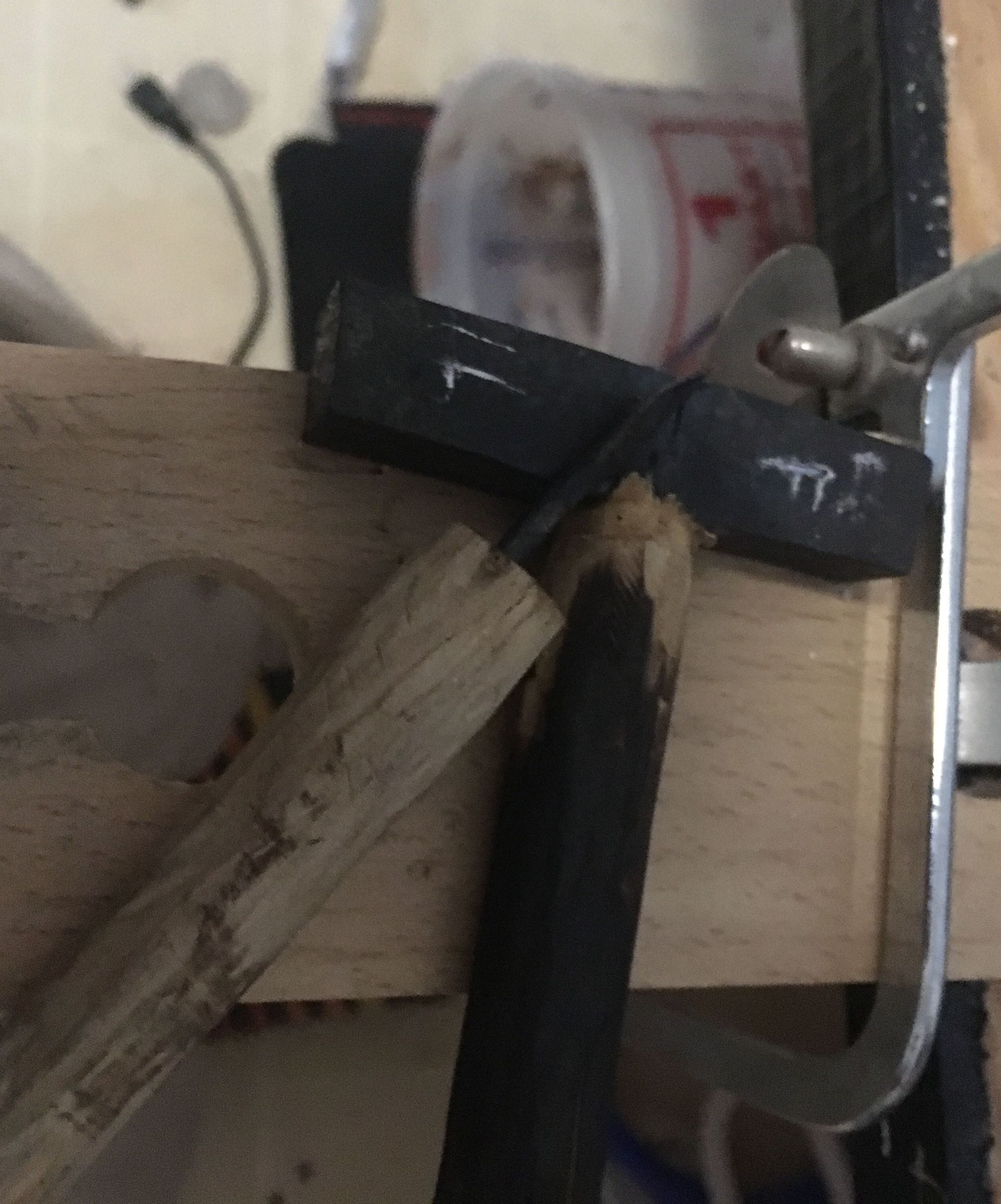

Step 1: The Waxes
This step is very important to the process because its what you eventually cast in metal.For this step you can carve or 3d print your wax pieces.Depending on what metal you want to cast with avoid super thin edges or parts, because some metals dont flow well when constricted (aluminum is the main one I have worked with) and other metals (bronze zinc copper and tin) all cast better in this way.Add a pouring spout and vents to the part amd proceed to the next step.
