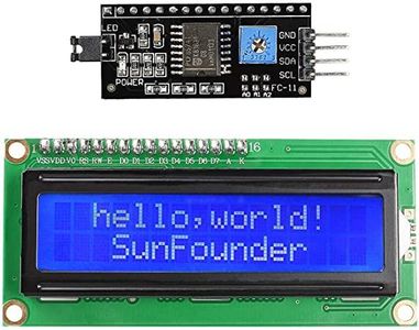

- LCD Screen
- https://www.amazon.com/SunFounder-Serial-Module-Di...

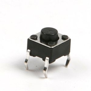

- Wires Button (use for start the machine)

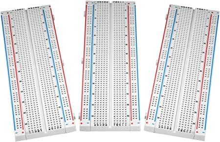

- Breadboard

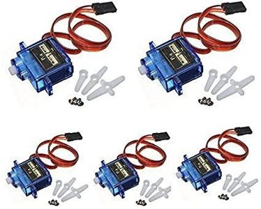

- Servo

With the LCD screen
- GND go with negative
- VCC go with positive
- SDA go with SDA
- SCL go with SCL
If you find out the the screen didn't show out anything, you can just Use the screwdriver to adjust the screw on the back, then it will be fine.
For the Servo motor
- Black, Red, Yellow (negative, positive, D pink)
- Black, Red, White (negative, positive, D pink)
- Brown, Red, Earthy Yellow (negative, positive, D pink)

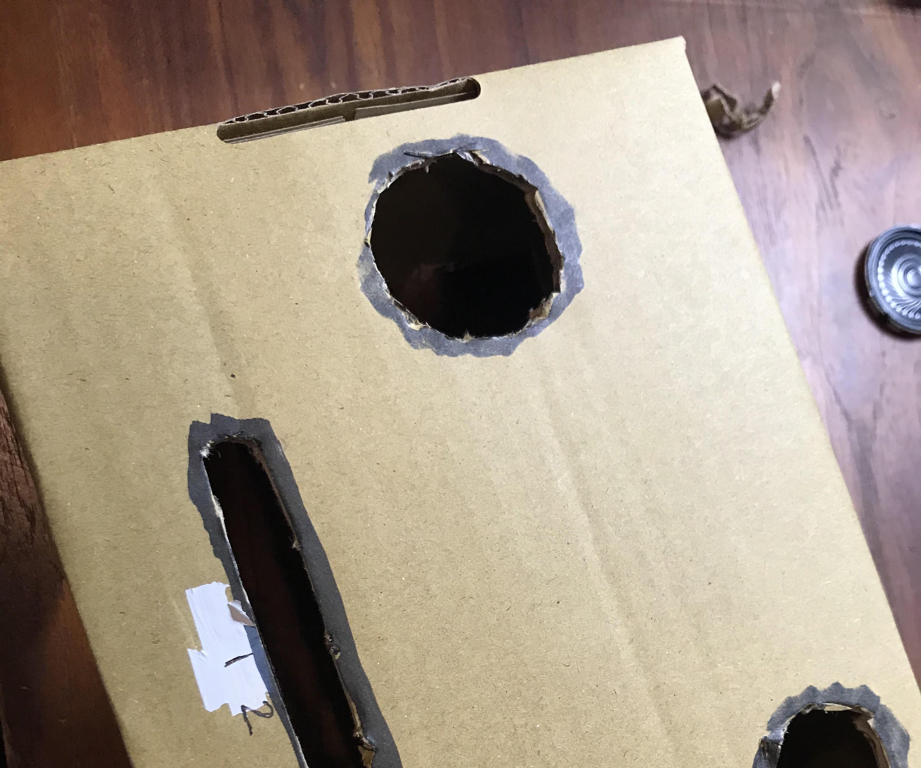

Step 4: Trim
Cut the boxes to these species :
- Length : 13 Width : 15 X1
- Length : 13.5 Width : 15 X1
THESE ARE FOR THE MAIN PART
- Length : 13 Width : 5 X2
- Length : 13.5 Width : 3 X2
- Length : 15 Width : 3 X2
- Length : 15 Width : 5 X2
THESE ARE FOR THE COVER
*Also on the cover, you can look at LCD and the button, cut a hole for each, on the side of the cover cut a rectangle that is 5x3 for the servo *
