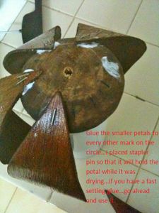

Drill a hole in the center to pass the wire. then mark the circle in 12 equal parts.
Glue the smaller petals to every other mark on the circle…I placed stapler pin so that it will hold the petal while it was drying…if you have a fast setting glue…go ahead and use it.
I think it looks pretty cute as it is :-)

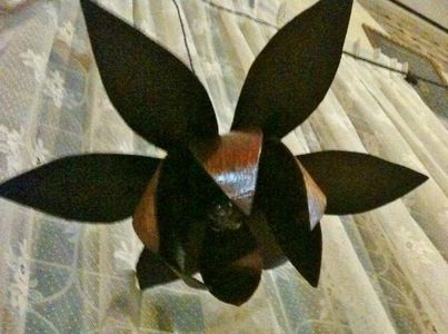

Now all you have to do is wire up your bulb and you set to go!
It would look great if you could like hang 2 or 3 flowers in various lengths in perhaps a cluster :-)
The curve of the larger petal will be placed in the opposite direction……I used hot glue here…
And then stapled it too.
