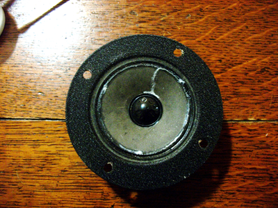

Step 3: Repairing the Paper Cones
The last part of the loudspeaker that needs repair is the small tweeter, or high frequency speaker driver, which has a tear in the paper cone, which has also separated from the accordion-style paper surround. These two issues need to be addressed before the little tweeter will sound right.

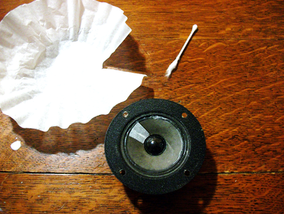

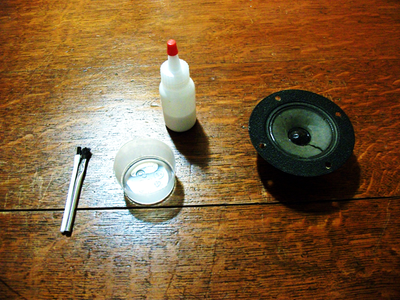

The glue supplied with the woofer re-foam surround kit has the valuable property of being somewhat flexible when dry, and it bonds readily to paper, making it an exemplary candidate for repairing paper cones. The idea is to use a diluted solution of this glue (about one to one), along with coffee filter paper and cotton fibers to create a kind of paper mache patch for a torn paper cone. The diluted glue soaks into the paper and actually bonds both sides of the tear back together, with the light-weight patch for added support. If the cone is torn at the edge, where it meets the paper accordion-style surround, cotton fibers can be used instead of the coffee filter patch. The cotton is used where the cone meets the surround because it is more durable over time than the paper, and also more flexible at the high-motion flexing point where the cone and surround meet.
Remove the tweeter from the loudspeaker enclosure to make it easier to work on. Pour a small amount of glue into a small tray or the bottom of a plastic cup. A blob about the size of a dime is enough to repair the small tweeter in the picture. Add the same amount of water, and mix thoroughly. Cut a piece of coffee filter large enough to cover the tear in the cone generously, and keep it hand for use in a moment. Brush the diluted glue over the tear in the cone, and align the parts of the cone so the edges of the tear are touching each other. Do the same with any other tears in the cone or where the cone joins the surround.
Take the coffee filter patch that was cut just a moment ago, and dip it in the diluted glue. Wipe off any extra glue, so the patch isn't dripping wet, but is more than moist, and place it paper mache style over tears in the cone. If the tear is bad, and needs stability, a second less wet patch can be applied, all the while being careful not to knock the parts of the cone out of alignment, so the edges of the tear remain touching. Pull off a very small pinch of cotton, so the strands and fibers stretch. Pull out those fibers and place them, several fibers at a time, along the edge where the cone meets the surround. Let the diluted glue that is there absorb the fibers and adhere to them. Try and get the fibers to adhere to both the surround and the cone. Next, let the whole thing dry in a safe place for 24 hours. Check to make sure the tears were all successfully sealed, and your done! Re-install the tweeter into the enclosure!
