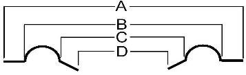

If the old fragile surround is mostly intact, you can estimate its thickness and measure its 4 dimensions, typically A B C D on a web guide, to set up the mould inner and outer roll diameters as well as the width of the flat parts. The width of the roll is important but If the surround is absent, estimate C and B as accurately as possible with an adequate A and D for attachment purposes. Some web research or enquiry to audio forums, might turn up images or dimensions to go by. Heavy cones from a 3 Way with longer cone travel (Xmax) might have rubber surrounds or of somewhat thicker foam. with a wider roll, compared to narrower rolls on lighter cones with an extended response and of lower Xmax from say 2 way vented systems. Exotic / vintage full range drivers are best left to specialists or dedicated DIY online forums
C sometimes has a small deliberate overhang beyond the cone edge for performance reasons. Note the polarity of wires before removal from box.
