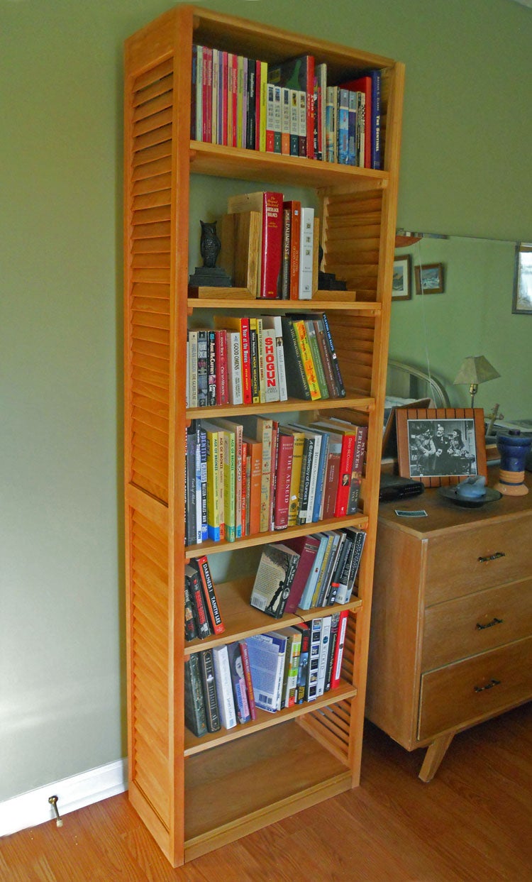

I really, REALLY needed a new bookcase (all of the books you see in this picture were either in a box, or crammed into shelves sideways on top of other books), but there were two problems. First, the only place I could fit another bookcase was in the spare bedroom, which is so small that I didn't want to overwhelm the space. Second, quality boards that are wide enough to make the sides of a bookcase are expensive. I quickly learned in my college woodworking classes that any boards more than four inches wide tend to get snapped up out of the supply room first. (In fact at one point an eight-inch wide board that I'd carefully planed and sanded was stolen and presumably chopped up for someone else's project. The perpetrator was never caught, NOT THAT I'M BITTER OR ANYTHING.) The paint-grade boards I bought for the shelves set me back more than thirty dollars, and I'd need something a lot nicer for the sides. Then at the Habitat for Humanity Restore I found a set of folding louvered doors, which would be wide enough for a bookcase AND the open design would work much better in a small space. Cost? Ten dollars for the set. And we're off!

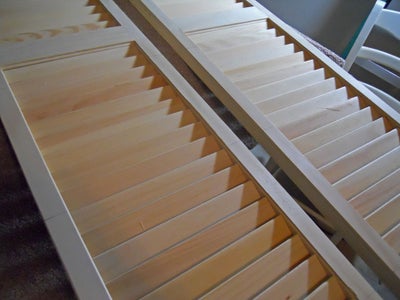

Plantation doors: 79” tall by 11 ¾” wide (I had to remove the hinges of course, but the holes will be facing the back)

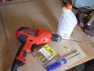

Step 2: Hardware Needed
Power drill
3/8” Drill bit
1/8” Drill bit
At least forty wood screws (1” long, preferably)
Screwdriver
Wood glue

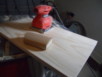

Step 4: Sand EVERYTHING
Take your time with this, and step away for a bit whenever you start thinking “Eh, that's good enough.” Sanding is the part that I so often skimp on, and I always regret it. .
Step 5: Mark the Placement for the Shelves
It's completely up to you how much space you want to allow for each shelf. I decided to alternate small spaces with large ones, with an almost thirteen inch space for the second to top shelf to leave lots of room for picture books. Once you've figured out where you want the shelves (make sure to allow ¾” for the thickness of each shelf), draw a line across the doors, marking the bottom of each shelf. Starting from the bottom, here is where I placed each line:
1 ½”
12 ¼”
23”
32 ¾”
45 ½”
55 ¼”
68”
78 ¼”

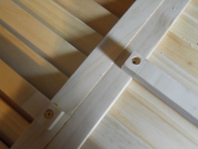

Step 6: Glue the Supports in Place
The supports will be held in place with screws, but this seemed like the easiest way to get them to stay in position when I drilled the holes. Make sure you position the rounded edges on the side WITHOUT the holes left from the hinges, and DON'T DRIP ANY GLUE. You can try to clean that stuff off of the wood, but nine times out of ten you'll end up with a little patch where the stain won't stay. Use small amounts, and don't smear it.
As you can see here, a carpet remnant makes a handy padding to keep your work from being scratched by the surface of the table saw. A table saw makes a handy work bench when your main work bench is so cluttered you can't do any actual work on it.

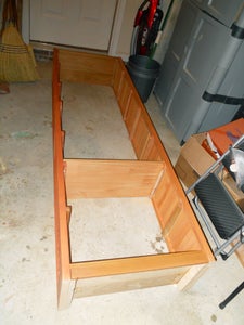

Step 9: Attach the Top and Bottom Shelves
The rest of the shelves can be slotted into place after it's been carried upstairs, but screws and some glue for the top and bottom shelves will make the bookcase rock-steady now. You might notice that I outsmarted myself with the lower supports. Making them 1 ½” wide, the same width as the front edge, looked like a good idea at the time, but it meant that I couldn't use screws to attach the shelf from the bottom. Ah well, I went ahead and screwed in the third-from-the-bottom shelf instead.
Step 10: Slide the Shelves in Place, and You're Done!
This design can be customized in a lot of different ways, and I'm already thinking of things I could have done differently. There's not a lot of room on the plantation doors, but maybe I could have cut a dado groove partway through the sides and then slotted the shelves into the grooves instead of having the supports glued underneath. And you could always make a more traditional framed bookcase (like this: http://www.margoshome.com/ProductDetail.asp?ProductID=2788) with a bit more effort. Be sure to post a comment or your own instructable if you try out any variations! I'm curious to see what else can be done with this.
