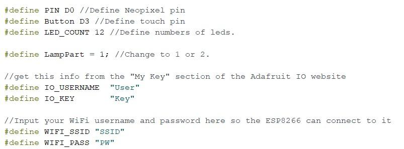

Download the files from below:
There are 2 files. A Lamp file and a Config. It is super important that the config.h file & connection.ino is in the same directory as the LoveLamp.ino file. Otherwise, the program won't work.
To get the 2 lamps to communicate we are using adafriut io. Its a online webserver where the user can post data points and many other things. We will only be sending (0,1,2) that's all.
Follow the steps below:
  1. Start by creating a new account.
  2. Locate "Feed" and create a new feed
  3. Give it the name "lamp"
We will use this feed later. Now you are done with, the online part. Good Job.
To program the ESP's we will need to change a few things. In the config.h file, insert your WIFI SSID and Password. Then you need to add your Adafruit Name + the feed (In your case, "lamp"). Then you need to define the lamp numbers. There are 2 options, 1 or 2. Lamp 1 needs to be called 1, ofc. To do this change #define LampPart x; in the config file.
This will control what lamp is witch, so name lamp 1, "1" and then change it to "2" when uploading the program for the other lamp.
That's actually all done for the programming.
You may create your own animation and stuff, but that's up to you. just read the comments in the code and you will hopefully understand it.
