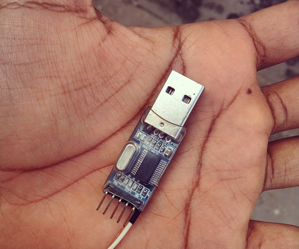

Very minimum parts used, programmed using Arduino, the code looks simpler than Blink!

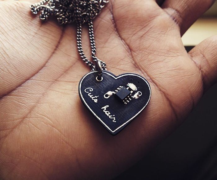

Step 3: Finishing Touches
I'm not a big fan of the yellowish color of etched PCBs, I did some searching on how to color home made PCBs painlessly and came across this nice article. He uses fabric dye, given my laziness, I used some black hair dye, boiled the PCB in the dye-water mix for about 10 mins and the PCB was transformed!
Make sure your PCB traces are tinned before you dunk it in the hot dye mix.
Program the ATtiny, solder all components and you're good to go!
This is my third prototype. The first one, I tried to etch one side without masking the other side of the PCB and you know, there was noting left of it. The second one, I messed up the switch circuit and soldered the Tiny wrong way, really really stupid mistakes. The third one, the most beautiful etch in my DIY history, it was all worth it.
In all, It cost me four LEDs, three microcontrollers, three switches, FeCl2 stains on my shirt and a weekend hidden away in my workroom, she better like it!
In case you're wondering why cute hair. ;)
