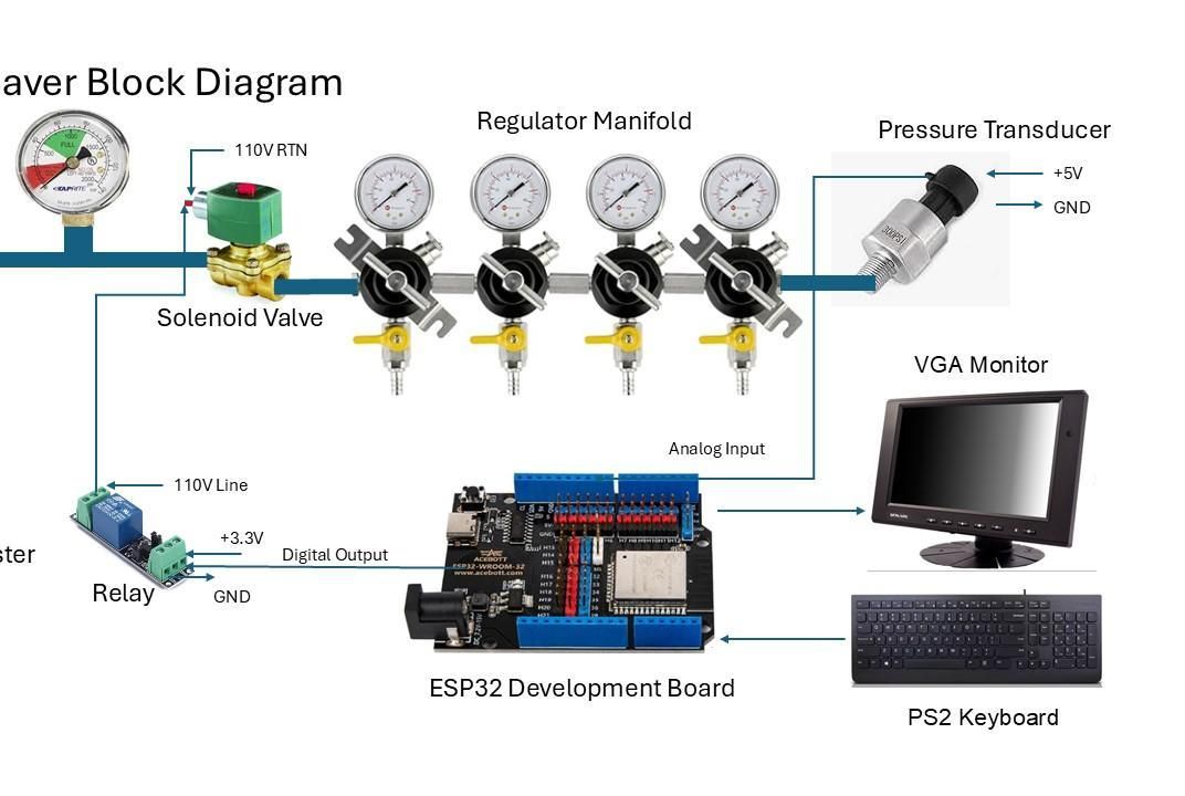

The above block diagram shows the entire system.
If your beer storage unit already has temperature control, you will not need the temperature sensors or relay. If you only want a local display, you can eliminate the ESP32 D1 R32 board and the interface wire.
My beer freezer is in the pool shack which does not have Wi-Fi. To get Wi-Fi, I installed an old ESP32 board under the eave and ran a cable between the two processors. They talk to each other on a serial interface.
I provided the following steps for the some of the hardware. More detailed steps and the software are available on GitHub.

Step 5: Relay
The Freezer Control Relay is used to turn On/Off the freezer. If you are using a refrigerator or you already have a freezer controller you do not this relay.
The following are the specifications for the relay I selected.
The power switch is compatible with 10A 250VAC. An Optocoupler Isolator:3V/3.3V power relay module supports photocoupler isolation control.
The freezer I use was an Insignia™ - 10.2 Cu. Ft. Chest Freezer. The start up current is 21.4 amps and the On current is 2.0 amps. The relay has handled the startup current fine.
The above schematic provides an overview of the connections. I included a picture of my final product. I got the line cord off a food blender that was broken. The line cord has 16-gauge wires. The plug and the box were pieces I had laying around. The relay is enclosed inside the electrical box. The plug in the box goes to the freezer. I broke the power tab in the AC socket, so each socket is individual. I wired one socket to the relay normally open connection and the other to the relay normally closed connection. When the freezer is on the power socket is off and when the freezer is off the power socket is on.
