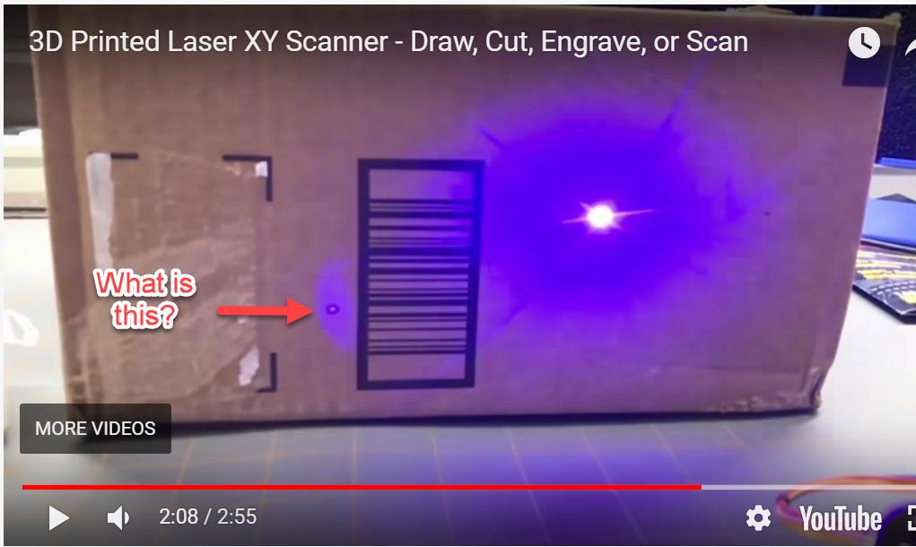

Step 13: Laser Scanner in Action - Video!
P.S. No sharks were harmed in the making of this Instructable.
