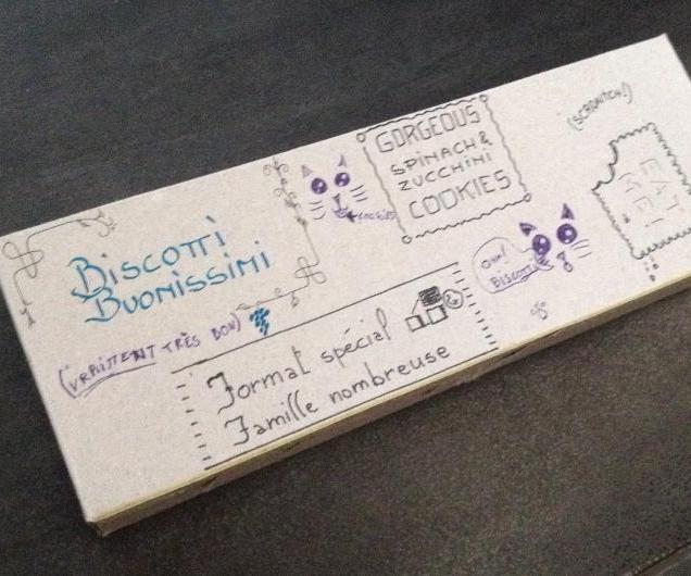

Take a box of around 10x8x4 cm (4"x3"x1.5"); I used the cookie's one in the picture, shortened to suitable length. Open it and find the small pasted flap, as in the picture; unpaste it to open the paper to flat.
Once flat, paper can be shortened to a suitable length, leaving some cm margin for later use (to close the box).
As you will see, the paper has some folding marks; following these marks, fold the paper in the opposite way: the aim is to get a box with the side out raw unprinted, easy to decorate; (the printed side will remain inside, not visible).
