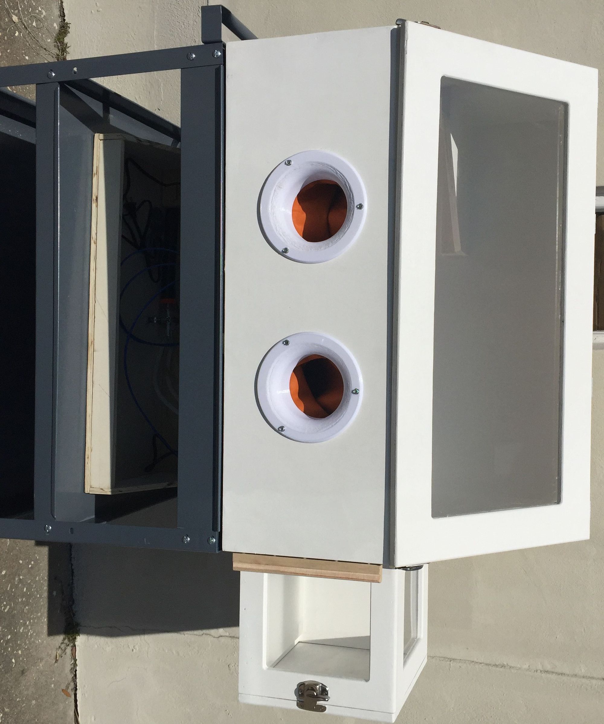

Step 5: Cut Glove Holes
Cut holes in front face for gloves. A comfortable distance for between the glove holes was obtained from a sand blaster cabinet of 6.5”. Each glove hole was cut using a 6” hole saw. The holes are measured at 3.5” from the bottom of the box. The center of the front face was measured and the holes based off of that rather than the distance from the outer edges.
Step 6: Assemble Box

Step 29: Install Flanges for Gloves and Gloves
Install 3D printed glove flanges into two glove holes for box. The .stl file for these flanges is included here. Attach gloves with 6" hose clamps.
