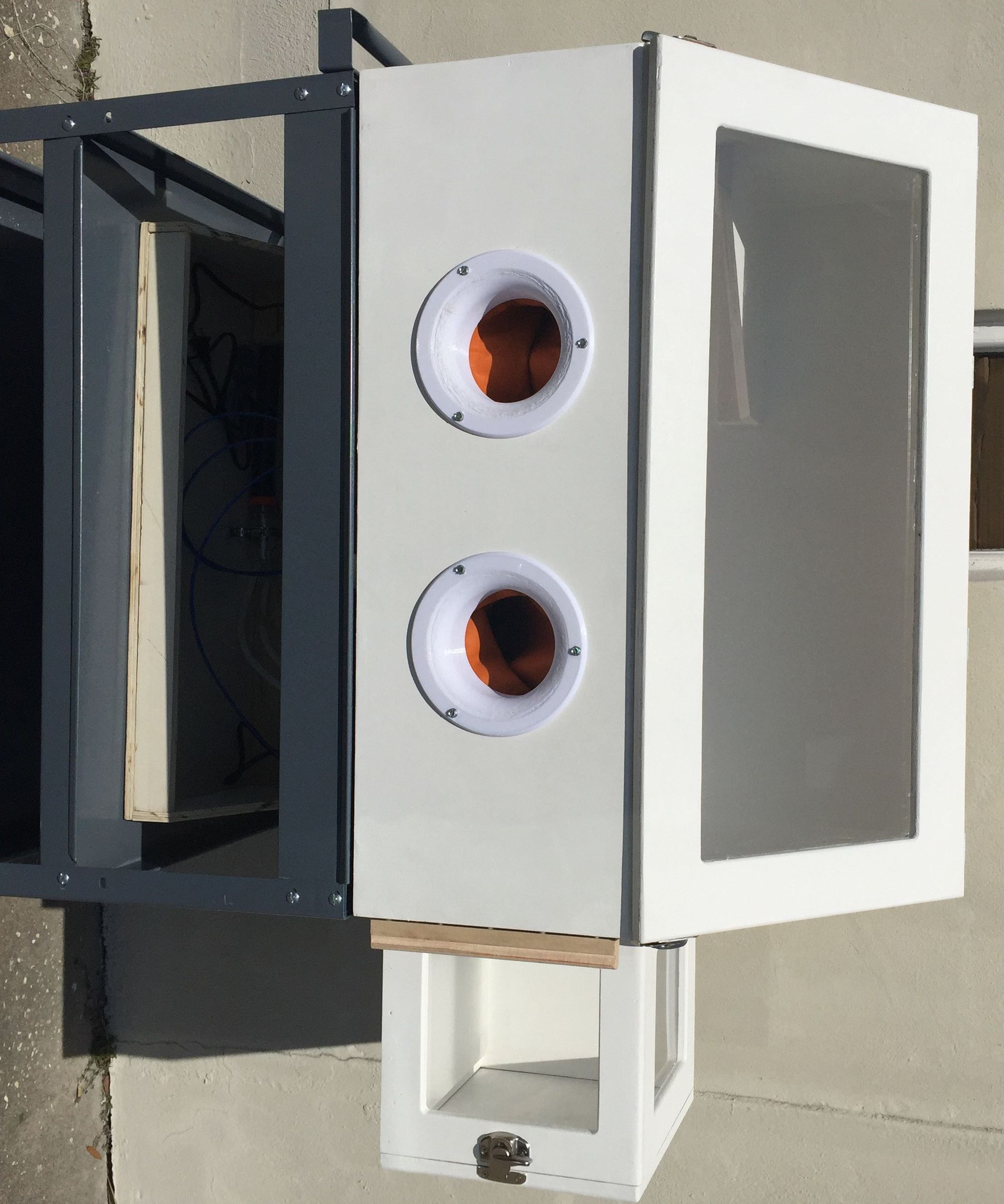

· 1 ECOTech glove box (refer to Build Instructions for details)
· 1 computer with USB port
Step 1: Setup Instructions
1. Inspect the ECOTech glove box. All doors should be easy to open and close, all wires configured as shown in the Build Instructions, all wires should be in good condition, etc.

3. Set up any other aspects of your planned experiment. If there are items that need to be inside the main chamber, or wires that must be passed through the hole in the side of the box, set these up before starting the program. While the program is running, opening the main door should be avoided. If needed, items can be passed through the smaller chamber in order to minimize the impact on the environment of the main chamber.
