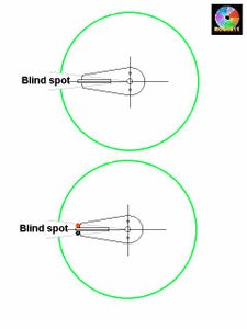

The idea of the chassis is to make it as thin as possible so that the section of the circle not lit by the laser is as small as possible, wires from the motor run up through tubes either side of the main support plate. The design also allows for "tweeking" to get a flat line once the build is finished.

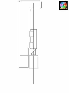

Step 8: The Chassis
There are no dimensioned drawings for this as a "one off" it was all done by the suck it and see principal.
The main plate was made long enough to attach a motor, a laser and a hanging up arrangement and had to be wide enough to attach the battery holders.
The spine needed to wide enough and long enough to mount the relay boards, the piece of tube needs to be a good fit on the laser module.
The motor plate was silver soldered to the main plate, the laser tube and the spine were soft soldered in place.
I also soldered the tubes for the motor wires along the junction of the main plate and the spine but these could be super glued in place.

I wanted a nice clean design with no visible wiring, the afore mentioned wiring tubes hide the motor wires as they pass the laser and ensure that the area of the chassis that the laser hits is as small as possible.

Step 11: The Rotary Mirror
This is by far the hardest bit to get right I can only tell you in a few words what to do.
The mirror needs to mount at exactly 45 degrees, it is mounted on a piece of round brass 8mm diameter with a hole in it to fit the motor shaft.
. I cut my brass rod by hand, holding it in the vice, using a hacksaw and a set square with a 45 degree side to get it as close to 45 deg as I could. I tickled it up with a fine file until I was happy with the angle.
A small piece of plastic mirror is then stuck on top with superglue. and filed to the finished round shape.
On final assembly I used a dot of superglue to stick the mirror mount to the motor shaft.
