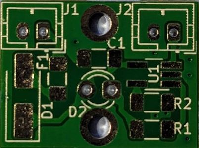

Step 2: PCB
I designed the small 20 x 15mm PCB using KiCad and had it manufactured by JLCPCB
The PCB Gerber Zip files can be downloaded from my website.

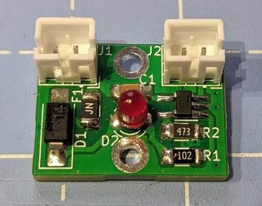

Step 3: Construction and Testing
The SMD parts are carefully soldered first. then the JST sockets and LED.
Double check polarities of all components, The diode D1 has a cathode white bar marking which should be near the bottom edge of the PCB as shown.
The LED D2 cathode (shortest lead or flat side) should be on the right (nearest the IC (U1))
Clean off flux residue using flux-remover spray and examine the PCB with a magnifying glass - look for any solder splashes( particularly around the IC).
It must be tested BEFORE connecting to a LIPO cell.
Connect socket J1 to a 5V DC regulated supply or a USB socket and the LED should light.
Measure the output voltage at socket J2 - it should be 4.2V.
Now switch your meter to the current mA range and measure the current across the output, it should be about 6mA.
(This is because the charger has detected that a LIPO cell is either not connected or it's voltage is below 2.9v and automatically switched to "trickle charge mode"
If the voltage and current readings are correct, check polarity and plug-in a LIPO cell and it should start charging.
The LED should light until the LIPO reaches 4.2V volts, fully charged.

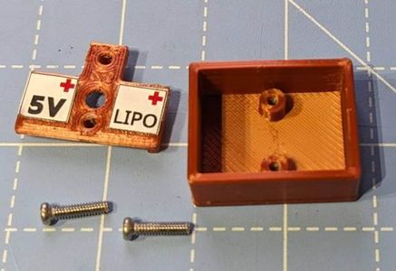

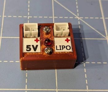

Step 4: Protective Case
The charger PCB should be cased to protect it.
I designed the case using RS Designspark Mechanical. The top and pcb are held in place with two M2 8mm long screws.
Paper labels can be glued on to the lid show the correct connections.
