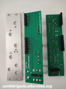

In the following the bill of materials needed to assemble the two PCBs (front board and main board). Panel board has no traces.
All components used are easily available and cheap, dont worry :)
Front board
4x 100K ohm linear potentiometer, WH148
2x LED, 3mm (your favourite color. These are the polarity indicaror LEDs)
1x mono jack connector 3.5 mm, female, PJ301M
1x single-pole double-throw (SPDT) switch, ON-ON
1x single-pole double-throw (SPDT) lever switch, ON-OFF-ON
24x (total) pinheaders, 0.1" spacing, male
Main board
2x TL074 op-amp
2x 1N4148 diode
2x LED, 3mm, YELLOW (the color must be respected here)
2x 100nF non polarized capacitor
2x 100nF non polarized capacitor (non ceramic is better)
1x 10nF non polarized capacitor
2x 10uF electrolitic capacitor
1x 100K ohm resistor
5x 1K ohm resistor
1x 2.2K ohm resistor
8x 47K ohm resistor
1x 4.7K ohm resistor
1x IDC connector, 2x5
24x (total) pinheaders, 0.1" spacing, female

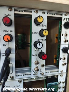

Since I already made some good-working external module for signal processing, I knew I could add some of them with little-to-no waste of space to my previous LFO project. In particular, two extra circuits found their way inside the module: an active attenuator/amplification stage and a level shifter (DC offsetter).
Even with this increase in features (which also means "increased components count") I could keep the module in the 6HP ballpark. This made the faceplate a little more crowded, but still more than decent operation-wise.

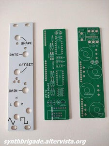

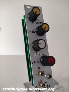

In this new iteration of the LFO module I have adopted a stacked board design instead of the previous "flag-like" design. It's more complex to draw (more work on my side), but more "professional" looking, if you know what I mean.
It is also more compact, then "less prone to damage", especially if one moves modules often.

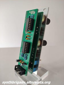

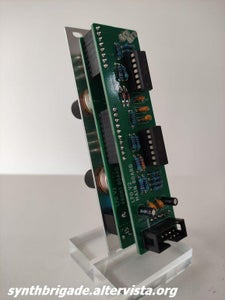

About pinheaders: I use male and female pinheaders for connections between boards. Female type should be used in the main board to limit the risk of short circuits in those rare cases where the main board is powered while not connected to the front board. Use male pinheaders on the frontboard PCB since there's not the risk of having it powered and pins not connected.
Start by assemblying the front board (the one with potentiometers and switches). The pinheader between the two single pole, double throw (SPDT) switches should be soldered first, or you will have a hard time soldering it after. The two SPDT and output jack are next. Please notice that the two SPDT are different, one being ON-ON (the waveform selector), one being ON-OFF-ON (the frequency range selector).
Every time you add a component, check that the panel board and front board are aligned, with no residual stress on PCBs.
The 4 potentiometers are of the same type and value (linerar, 100K ohm, single turn, 6 mm shaft). I use common WH148 potentiometers that are intended to be installed perpendicuarly to the PCB. I bend the pins and use wires cut from resistors or other components to elongate the pins and reach the PCB. First lock the potentiometer to the panel board, check that boards are parallel and then solder it in place.
To have perfecly aligned LEDs, place them in position first, firmly connect panel board and front board, align LEDs to the panel then solder them in place. This way they will be perfectly aligned to the panel, with no residual stress on their solder pads.

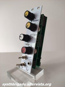

Step 4: How to Use
The module is straightforward to use.

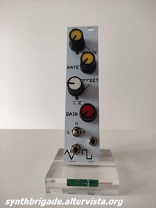

First, select the waveform with the ON-ON switch located in the bottom of the module. Available waveforms are triangle and square.
The "Shape" potentiometer gives full control over the skew of the waveshape. On the square wave it affects the duty cycle, while on triangle it shapes continuously from backward saw, to triangle, to forward saw (ramp).
The second potentiometer ("Rate") modify the oscillation frequency of the wave of choice.
The frequency range can be set through a dedicated, 3-positions switch located on module's bottom. Frequency ranges are: 0 - 10 Hz, 0 - 100Hz and 0 - 1000 Hz. You can hit higher frequencies by using smaller caps than those I adopted.
"Offset" potentiometer is used to shift up to positive or down to negative your oscillating voltage. This has practical applications such as in modulation of some external module parameter expecting voltages with a well-defined polarity.
The fourth potentiometer is used to increase/decrease the gain of the output signal. Gain goes from zero (completely attenuated wave, full counter clock-wise potentiometer) to 2X gain (8Vpp circa, full clock-wise pot).
