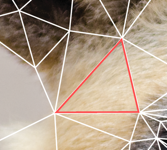

Step 4: Coloring
After creating a live paint, you can now use the Live Paint Bucket [K]. Use the eyedropper tool [I] to select a color within the triangle. Then, use the paint bucket tool to click the area in the triangle, which will be highlighted in red. If you want to redo a color you can press undo [Command + Z] or remove fill on your color panel (as seen in step #2 above) and fill in with the live paint bucket. Now color to your heart's content.
