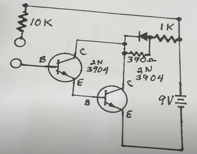

Step 1: This Is and Exemple of a Base Leakage Tester Schematic
This Is And Exemple Of A Base Leakage Tester Schematic we can found on internet. Those transistors are in Darlington configuration to rise the gain. The led light up until the capacitor is full. If the led doesn't turn of completly, the capacitor is faulty. My device id doing the same with more option.

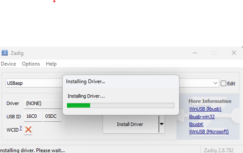

Plug in your USBasp or USBtiny device in your computer and let Windows detect the device (it will report driver not found). If a window pops up asking to search for driver, just close it or click on Cancel.

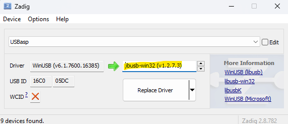

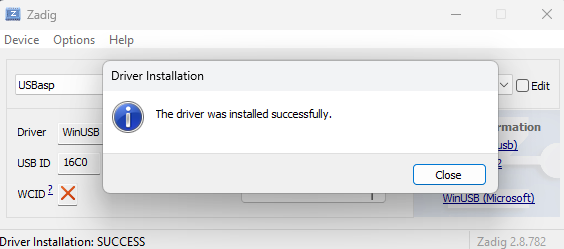

At this point, download and run Zadig, it should detect the USBasp or USBtiny, or any libusb device that you have. Then in the selection box (see picture), choose libusb-win32 (v1.2.7.3), click on Install Driver, and wait for the installation to complete.

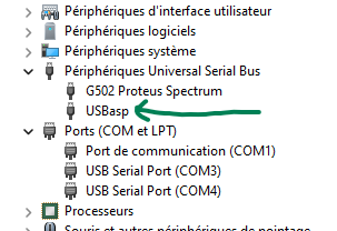

Check in device manager for atmel usb device = ok. No exclamation mark anymore

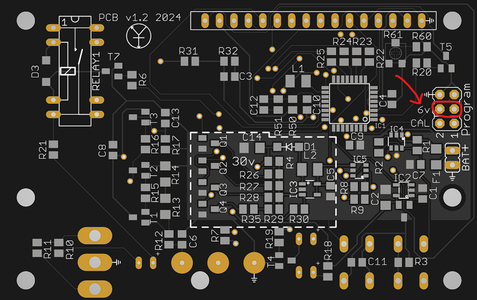

Step 5: Jumper Config
If you are using 4 AA ou AAA battery you need to install a jumper on the program header. In the middle, you will see 6v. This jumper is needed to tell uC we are running on 6v to track battery life.
If the jumper isn't installed. The device will run unaffected but, with a wrong battery empty logo.
Step 6: Diode Calibration Voltage
To do a calibration of the ADC we will use a jumper to enter in config mode. In fact we do not config the ADC. We are changing the multiplication number in the software.
It's important to turn off the device before to install the jumper
On a turned off tester, install or jump the 2 wires on the picture. Power on the device.
A remove jumper message will appears. Remove the jumper.
In configuration mode only one button is working, the option button.
Only one function can be done with this button, rising the readout. We can't go back. If needed just remove battery and restart again.
With a Voltmeter, check the readout between + and D- and then, press the option button until you are reading the same thing. Button can be long pressed or short pressed.
When it's done, just remove power and it's done.

T4, T5, T7
What those transistor have in commun ? If you look carefully. The collector of those is connected to 9v and without a resistor.
Why is that so? It's for the efficiency. If for exemple it was on 5v. That's means if we have a 9v battery, we must lower the voltage of 4v in heat, by the regulator. This isn't a good thing. By this little attention, we improve battery life and save the power dissipation. Here, also, we didn't have any collector resistor. The current is limited by the base resistor. 5v-.7 = 4.3 volts. 4.3v/100k=43uA. 43uA x Hfe(200)= 8.6mA
8.6mA is the collector current no matter the voltage of the battery. The leds will always light-up at same intensity.
Relay1 (Discharging Relay):
This relay discharge the capacitor at power off through the led/resistor in parallel. In the same time uC disable the voltage input on the step up power supply. While the relay is closed, it is also normal to see the charge LED light up. C5 and C14 are discharging at the same time and the amplifier is activated.
I tried to bypass this relay. All attempts has failed. Because we must install this in parallel with DUT (device under test), anything else but a relay was too leaky, yes a mosfet too. I didn't have other choice.
The R21 1.8k resistor is calculated to discharged 16.66 mA on 30v. P= 16.66mA x 30v = 0.5 watt

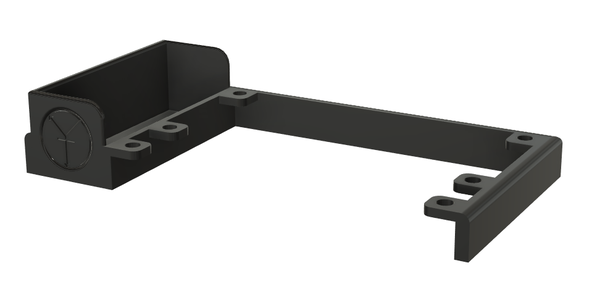

Step 8:
This is the optional holder an cable holder.
