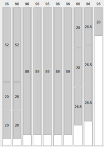

Before helping my dad out I drew the plans in CATIA and made a dimensioned drawing with a bill of materials.  I've provided the cutlist for the 2x4s, for the sheet goods and 4x4, use the "Finished Dimension BOM" (Bill of Materials) off the drawing.  My intention is to be able to build the bench almost entirely from the 11x17 pdf plan below.
How to read F/N's:
For this Instructable, I've labeled the parts used in each step with a Find Number (F/N column on the drawing) that matches a part in the BOM.  For example if you read "Pick up a #5", after referencing the drawing you'll see that I want you to hold in your hand one of the 52" 2x4s.

The piles are there for you to pick through!  Inspect the boards for any cupping, twisting, cracks, excessive knots, cracks, but remember to stack the boards nicely when you’re done picking through them.
Inspect the MDF sheets for crushed edges, MDF is dense (why I used it) but has edges that can be easily damaged.  Later we’ll band the edges with hardwood which will help protect it.
Room is left on one of the 2x4’s for some incompetence cuts, but if you’re worried, grab an extra one.
