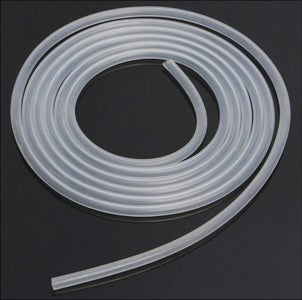

The size ID5/OD7mm or ID6/OD8mm will fit your water pump nozzle. I recommend using silicone resin for the hose material rather than polyvinyl chloride resin, as it is more flexible and less prone to bending. About 4 weeks into using the silicone hose, green algae started growing inside the hose. Therefore, I recommend that the hose be of a color that does not allow sun light to pass through.

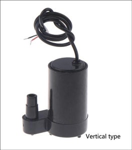

Model A: Battery powered
There are various types, such as horizontal and vertical types, but any of them will do. It is preferable that the power supply specification supports 5V-12V. Pumps with USB connectors seem to be limited to 5V power supply, so you need to devise a way to operate them at 5V.

  • Water pump with USB plug( sample )
There are various types, such as horizontal and vertical types, but any of them is ok.

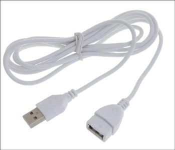

  • USB Extension Cable Extender A Male to Female( sample )
Use the female connector side.

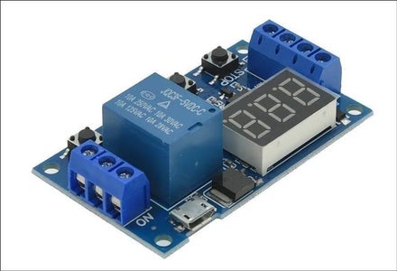

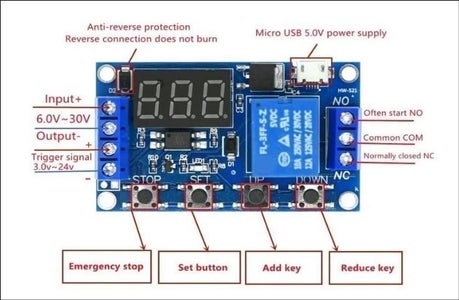

Step 1: Set Operation Mode and Time Interval
The automation relay module is equipped with a microcontroller, so you can set the relay to turn on/off at any time you like! (Can be set from 0.1 seconds to 999 minutes)
Furthermore, seven different operating modes can be set, and it can also be powered by a USB 5V power supply, making it extremely versatile.
This watering system uses the "P3.2" operation mode. In this mode, the system can be set to operate in such a way that "one minute of water supply is repeated 24 times at 4-hour intervals".
How to set parameters?
  1. The module is powered up, the display at the current work mode (P1.1 default mode), then enter the main interface; press "SET" button for 2 seconds after release to enter mode selection interface; a short time by pressing "UP", "DOWN" key to select the mode (P3.2).
  2. Select the mode (such as P3.2), short press the "SET" button, then the parameter to be set flashes ( "OP" on-time, "CL" off time, "LOP" cycles ( "---" represents infinite loop)), by "UP", "DOWN" keys to adjust the parameter value, support long press (rapid increase or decrease) and short press (increase or decrease one unit); then short press the "STOP" key to select the decimal point position, select the time range (0.1 seconds to 999 minutes); short press the "SET" button to set the next parameters of the current mode of procedure is as above.
  3. After the parameters are set, long press "SET" button for 2 seconds then release, the name of the current mode will flash once, and then return to the main screen, set the parameters of success!

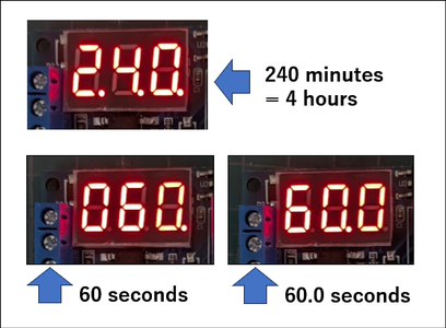

How to choose the time range?
After setting the mode selection screen parameter value by a short press "STOP" button to select the time range;
  • x x x. decimal point in the unit place, Timing range: 1 second to 999 seconds.
  • x x.x decimal point in decade place, Timing range: 0.1 seconds to 99.9 seconds.
  • x.x.x. decimal full brightness, Timing range: 1 minute to 999 minutes.
For example, to set "OP" to 60 seconds, move the decimal point so the digital display reads "060." or "60.0".
For example, to set "CL" to 4 hours, set 240 minutes. Move the decimal point so that the digital display reads "2.4.0."
Relays enable mode:
In the main interface, short press the "STOP" button to switch between ON and OFF, the current in which the state will flash, and then return to the main screen. (This feature is an emergency stop function, click off the relay)
  • ON: Relay allows conduction in the "OP" on-time
  • OFF: relay prohibit conduction is always closed
Sleep mode:
Press the "STOP" button for two seconds and then release to switch "C-P" and "O-d" state, in which the current state of flashes and then return to the main screen.
  • "C-P" Sleep mode: five minutes without any operation, the digital display automatically turns off, the program running as usual
  • "O-d" normal mode: digital display always open

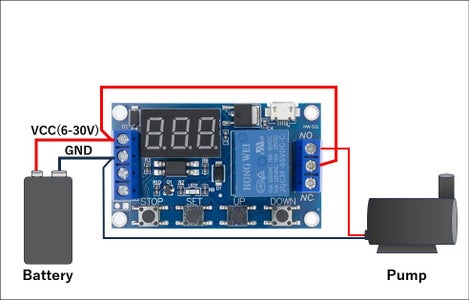

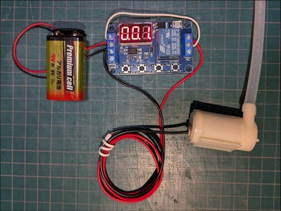

Step 2: Assembling for Battery Powered Model
The number of parts is reduced by sharing the power supply between the relay module and the pump.
  • Wire the positive battery wire to VCC(6.0-30V)
  • Wire the negative battery wire to GND
  • Wire VCC(6.0-30V) and COM with a jumper wire
  • Wire the positive pump wire to NC
  • Wire the negative pump wire to GND
How long can it be operated with 006P dry cell battery?
Battery consumption depends on the amount of time the pump is running. The current when the pump is running is about 140 mA, and the current when it is in standby is about 3 mA.
Let us estimate the case where the pump operates for one minute every four hours. Assuming the capacity of the 006P dry cell battery to be 400 mAh, it should last about 5 days, but in reality, the relay module will repeatedly restart after 3 days because of the high current flow during pump activation.
Since operating times vary depending on the environment, I recommend several trial runs before actual operation.

Step 3: Assembling for USB Powered Model
Wire the pump so that the power supplied by the USB connector flows to the pump.
  • Wire the +5V of the USB connector to COM
  • Wire the GND of the USB Extension Cable to the GND of the USB connector (black wire)
  • Wire the +5V of the USB Extension Cable to the NO (red wire)
The USB Extension Cable is secured to the relay module with a cable tie or hot bond.

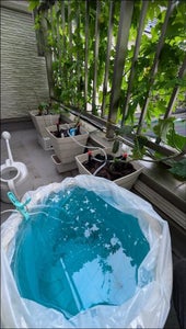

Step 4: Place the Water Tank and Install Hoses.
I did not buy a large tank, but set a plastic bag in a large flowerpot to hold the water. The water in the photo is blue because liquid fertilizer is added. I used clear plastic bags at this time, but I recommend using black plastic bags that do not allow light to penetrate to reduce algae growth.

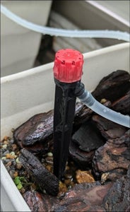

For water distribution, I used the Automatic Watering System Kit ( sample ) . The kit also comes with a hose, but I use a silicone hose because it is more flexible and easier to use. The pump used here is not powerful, so the hose is branched into smaller sections to ensure that water is distributed evenly.

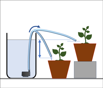

Be aware of the water level
The tank should be positioned so that the water surface is lower than the outlet of the watering hose. If the water surface is higher than the outlet of the water hose, water will continue to flow out due to the siphon principle after the pump stops.
How big a tank of water do you need?
The amount of water required depends on the length of time the pump is running. Running the pump for 1 minute will distribute 1 to 2 liters of water. In my environment with Micro Submersible Water Pump, it distributes 1.4 liters of water per minute.
If you run the pump for one minute every 4-hours, you will need about 10 liters per day. If a large tank is not available, it is necessary to provide multiple watering system to shorten the pump operation time.
