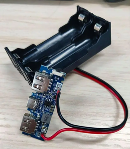

A power bank is nothing more than a battery cell, a charging module, and a discharging module. If the battery is replaceable, the charging module can be omitted, and a boost module can be directly added to the battery cell.
  1. 18650/21700 battery cell and battery box
  2. Integrated charge and discharge power management module
  3. Dental floss box
  4. Wires
  5. Tape
  6. Soldering iron
Step 1: Welding
There are only two interfaces on the whole motherboard, which can be welded on both sides. Just connect the + to the positive pole of the battery cell and the - to the negative pole of the battery cell. In order to replace the battery, I connected a battery box. I connected several boxes in parallel to the number of cells I want to put in. After the wires are connected, put in the lithium battery and you can charge the phone.

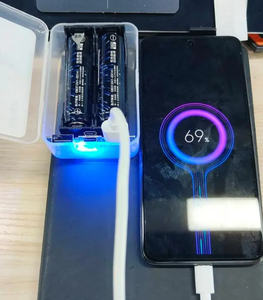

Step 2: Charging Test
When charging, the phone is tested for charging, and the charger voltage is about 4.6V, the maximum current is 1500ma, and the stable current is about 1000ma. The specific output current is related to the charging protection of the phone and the power of the phone.
When charging the phone, the overall heat is also a bit high. The fingers can feel hot when touching the components. The inductor component and the USB interface are the hottest, but the battery is basically not hot, so it is still okay. I don't know if the battery is too bad. It will show full soon when charging. After it shows full, it actually takes a long time to charge the charger before it is really full.
Step 3: Accident
During the process, one of the batteries was installed upside down, causing a short circuit between the positive and negative poles, and sparks flew instantly. Then the battery was quickly taken out. It was a little hot, but not serious. Fortunately, the battery and the power board were not damaged. The wires and tape were burnt. Later they were re-welded and made smaller so that it could fit into the dental floss box, and then glued down later.
