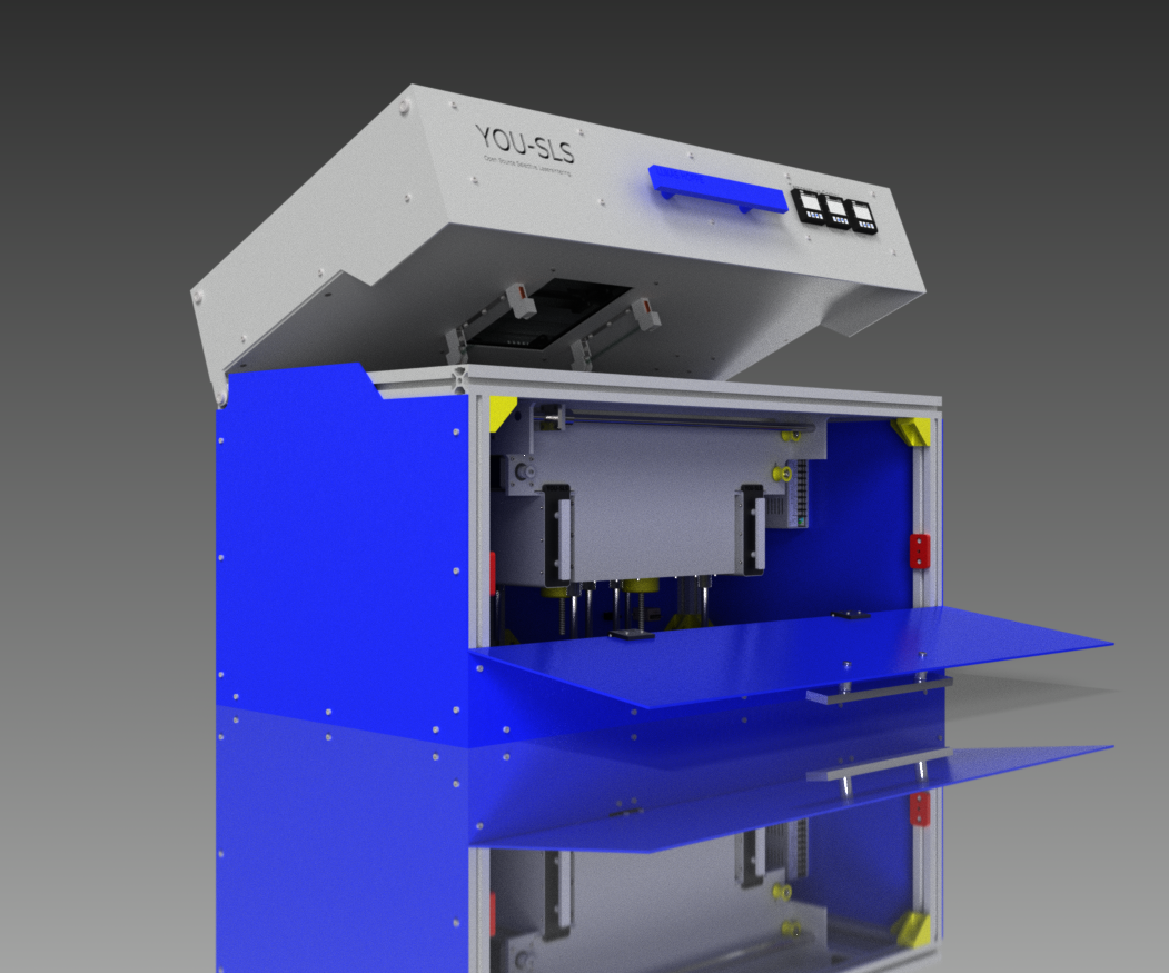

If you are interested in 3D printing, you might also want to check out my other instructable for a revolutionarily cheap DIY SLS 3D printer

I am currently working on a sls 3d printer, have the option of laser cutting a vast amout of parts with your own laser cutter would be incredible. thank you for considering
