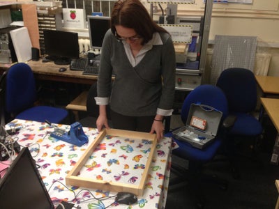

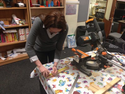

If you are buying supplies for your frames, you will be able to choose what size of frame you wish to make and buy accordingly. In our case, we were using scavenged wood, so the size of the frames we made was partly governed by making the most efficient use of what we had to work with, as well as the size of frame we wanted to eventually end up with, and the size of the vinyl we were physically able to cut (there is no point having a huge screen if you only need a small one or can only create small images to use on it!)

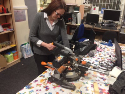

Once you have decided what size frame you need, measure your wood and cut it to size. Because we used a pocket hole jointer, we did not have to mitre the edges, only straight cuts with the saw.

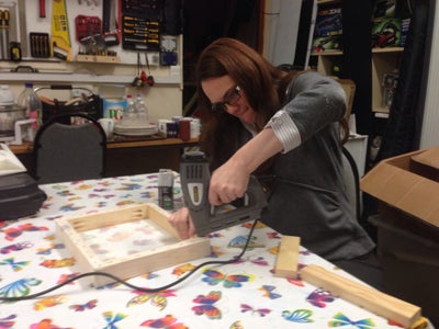

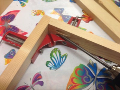

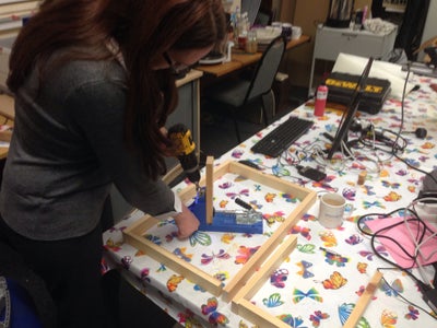

Step 2: Building the Frames
We used a pocket hole jointer to build our frames, which made it very easy. All we needed to do was set the jig, clamp the pieces, then drill the pocket holes. Once done, we could just screw the pieces of the frame together very simply to create a frame that is very sturdy and strong. Because we had a framing clamp we used it, but it is not essential - it just makes it even easier to make sure that everything is nice and straight and screw the parts together tightly.

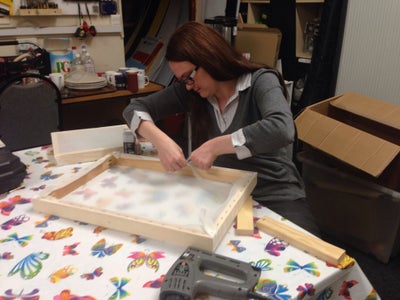

Step 3: Adding Mesh

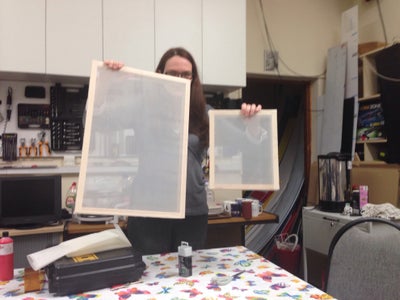

Once we had built the frames, sanded them down well to make sure they were completely smooth, then we stretched the mesh tightly over them and stapled it in place. The mesh needs to be as taut as possible, with no creases or loose areas, without being so tight that it rips. The easiest way to do this is to staple the middle of the screen first, then move outwards to the corner of the frame. Don't be too stingy with the staples - we used one every inch or so. A second pair of hands to hold everything taut for you also helps!

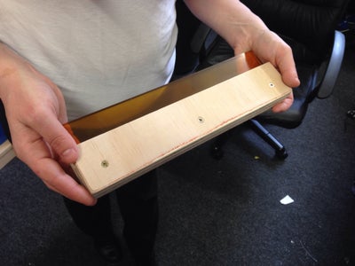

Step 4: Making a Squeegee
Tada! Your bargain frame is made. As long as it is looked after, and cleaned and dried promptly after each use, it can be reused over and over again.
The next thing to make is a squeegee. We have been informed that you can use car squeegees at a push, but since we had made a good, long-lasting frame, we felt that it was worth having a good, long lasting squeegee as well. We purchased a length of replacement squeegee from ebay quite cheap. To make a useable squeegee, all we did was clamp this between two offcuts of wood, screw it securely in place, and sand down the edges.

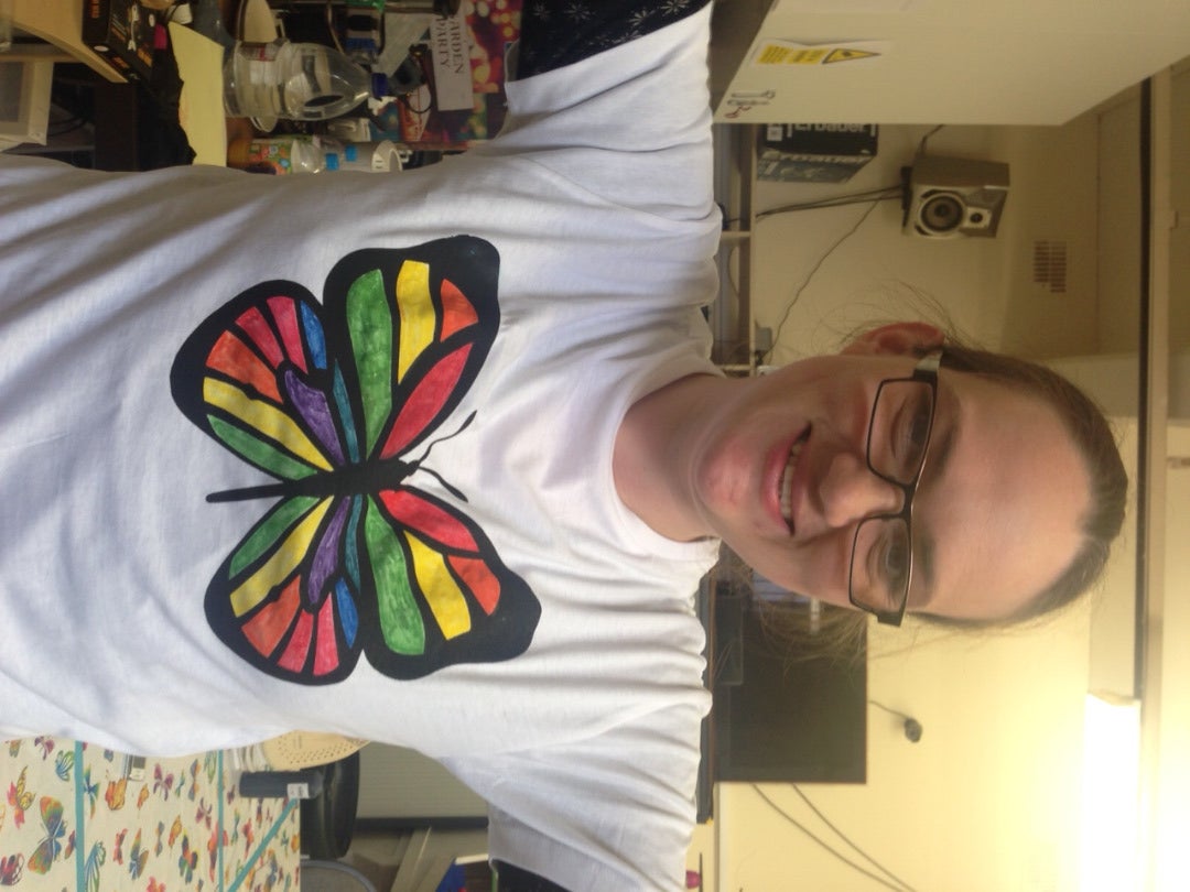

Step 8: Colouring in Your Creation
Once you have finished printing, you can colour your design in! You will need to use proper fabric painting pens (we used Tulip brand) and you can let your imagination run wild! The result is beautiful, bright, rainbow coloured T-shirts that are totally unique and lots of fun to make!
