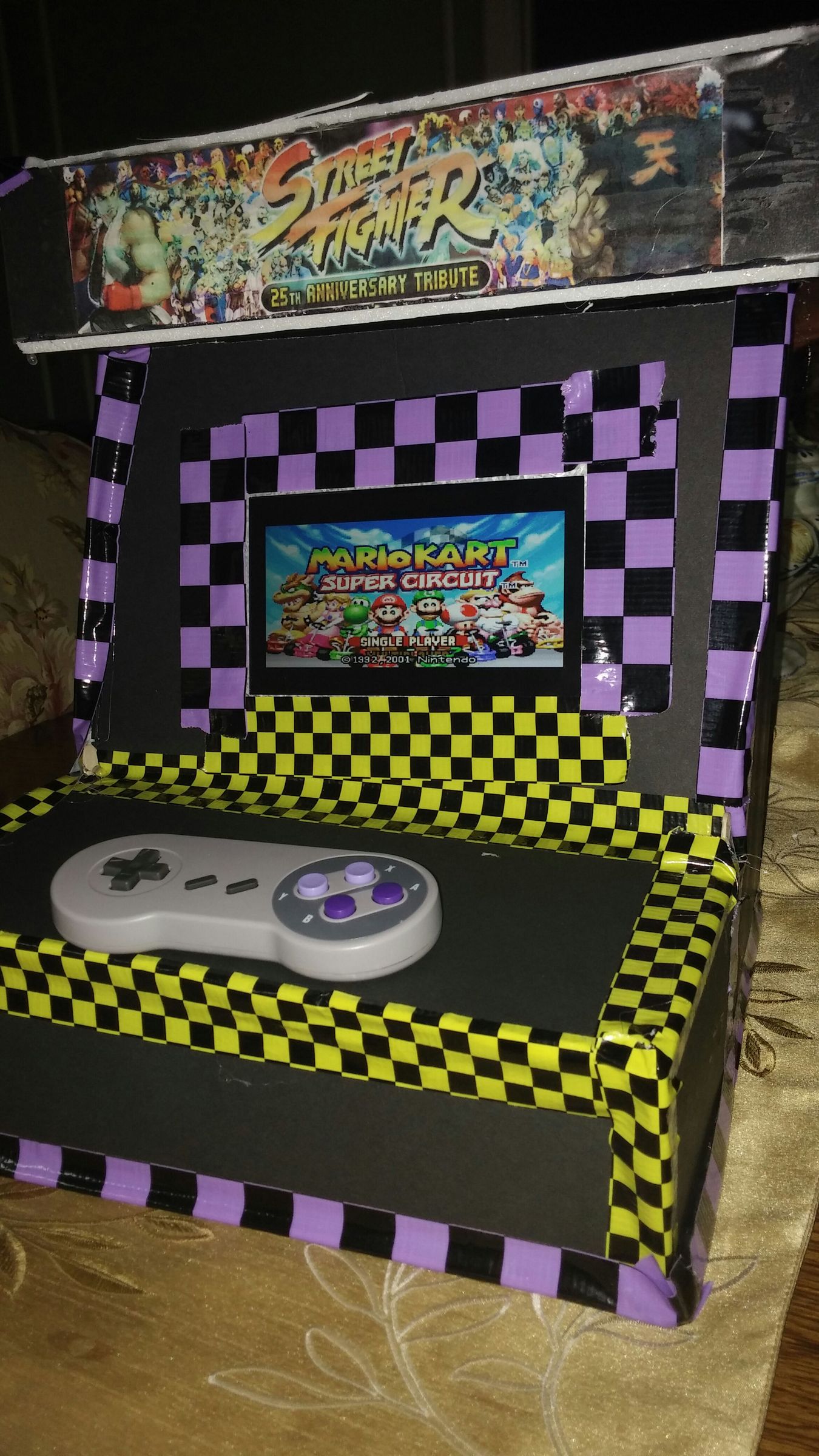

I am in the middle of building a raspberry pi bartop gaming cabinet that runs off battery. One of the issues I ran into was that the 7" monitor I was using had no speakers, and other speakers took up too much power from the battery to run the PI.

now that our soldering is done, put some kind of protection on those connections! I put hot glue around the solder spots, and hot glued the cord down at the base to relieve the tensions from the soldering. I also wrapped tape around the wire stubs to stop the red and black wires from bumping and shorting out.
Step 5: TEST IT. YAYAY
Moment of truth. Plug the Male usb port into a power source. If the battery indicator light comes on (the red light) then it should work fine.
