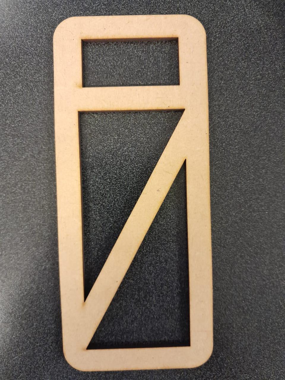

Step 4: Laser Cut
Later we cut the pieces with a laser cutter (first image): 4 times the "leg" file (second image), 2 times the "foot" file (third image) and one time the "hip" file (fourth image).
Step 5: Piece Adjustment
After that we adjusted only the leg piece introducing a hole for the screw on the top. We also had to add a space for the servomotor cable to fit in.
