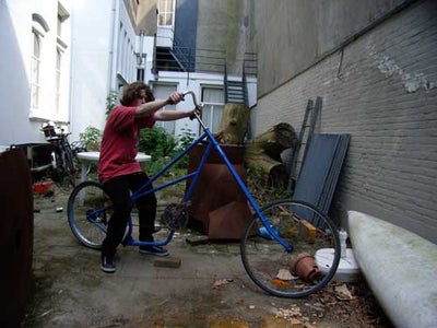

In this Instructable you can see how to make a cool chopper/lowrider bike the cheapest way with some old bikes. Watch the bike down below, I just made it with two old bikes and some iron pipes.

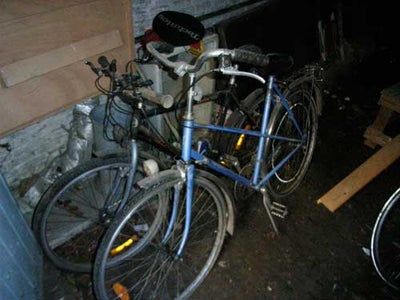

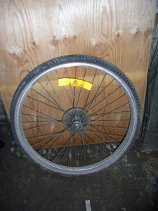

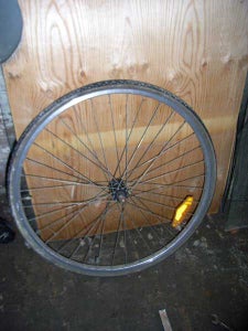

- At least two old bikes, one bike is also possible but gives your design lesser freedom.
- Bikes need to have two good wheels, the best is to have two different sizes. Notice: you should use a front and a rear wheel.

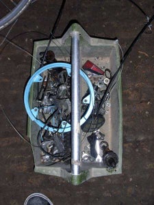

- Keep the spare parts of the bikes, you could use them to finish your bike.

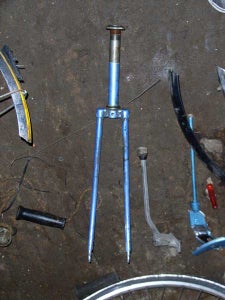

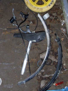

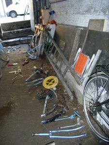

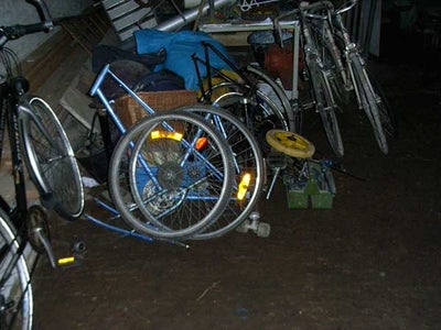

Step 2: Take the Bikes Apart With Handtools.

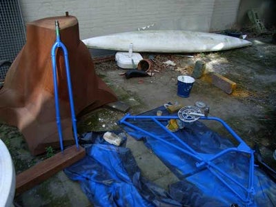

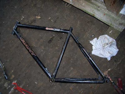

The first thing you do is taking the bikes apart and look what materials you can use.
See the material list.
Take them apart with the handtools, later you're going to saw.

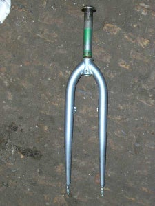

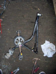

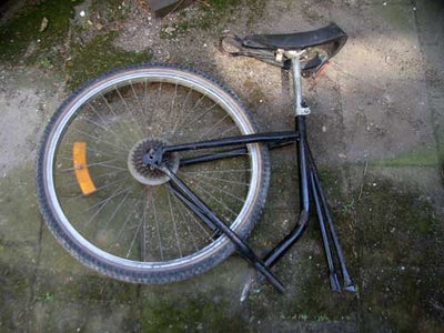

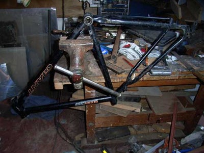

Step 3: Saw the Pieces You Need
Now you can saw the right pieces you need from the frame and the front fork.
Saw with a iron saw and mark the place where you're going to saw.

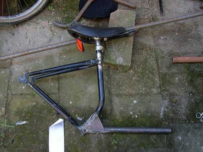

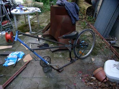

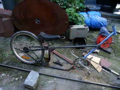

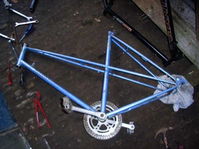

Step 4: Try to Fit the Parts Together and Start Welding.
Try to fit the frame parts together and measure it comparing your body.
Saw the pipes in the correct length.
Start welding the different parts together step by step.
Last welding job: extension of the front fork, use two iron pipes of the same length.
Watch out: Keep the frame straight and the wheels should be in line.

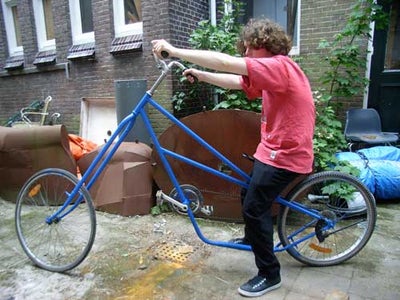

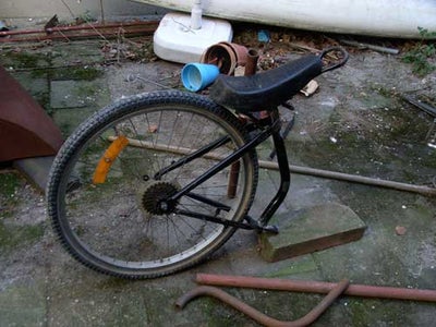

Step 5: Put the Bike Together.
Complete the bike by putting the different parts together and watch if everything fits well.

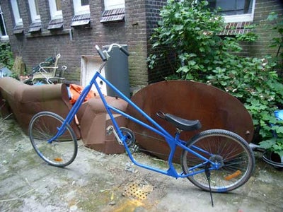

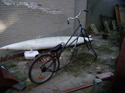

Step 7: Finishing the Bike.

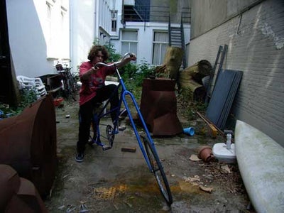

When the paint is really dry, you can put al the parts together again.
Last step is lengthen the chain by nailing the two pieces together and putting it in place on the bike.
Now the bike is ready to ride, only watch out you don't have brakes.
