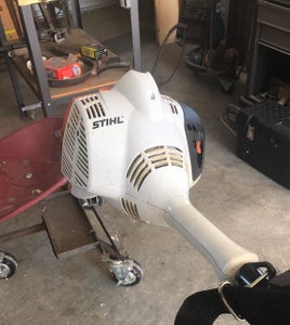

The Stihl FS56 string trimmer is a popular model with homeowners. But, there is some frustration because the gearhead has no grease fitting or plug for adding lubricant, and owners have some anxiety about early failure of the gearhead. This Instructable shows a non-invasive way to add grease for the gears.

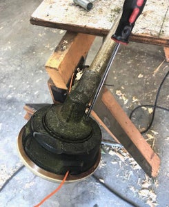

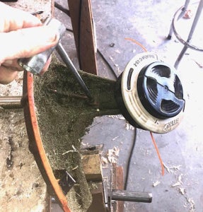

(First photo) Use the TORX tool provided to remove the mounting screw for the shield. Lift the rear end of the shield and remove. (Second photo) Insert a rod into the hole on the gearhead so it goes down into the stringhead to lock the stringhead from turning. A medium Phillips screwdriver works well. Remember that the threads for the string head are left hand or reverse. (Third photo) Use the TORX tool to loosen the clamp screw on the gearhead. Twist and pull the gearhead from the drive tube.

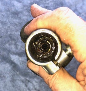

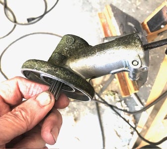

The first photo looks into the gearhead’s collar for the drive shaft. Although difficult to see because of grease and problems with lighting the inside of the collar, at the center is a square socket to receive the square end of the driveshaft. There is a snap ring under the visible grease and I wanted to remove the snap ring. I think removing the socket and gear for the angled shaft would allow adding grease to the gearhead, but I found an easier way. (The snap ring under the grease would require a snap ring pliers with tongs at least two inches long. I contemplated making one in my shop, but noticed something before I could begin.)

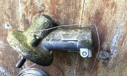

See the second photo. As I was contemplating how I could remove the snap ring I turned the vertical shaft by hand. I noticed grease inside the collar for the drive tube was growing in volume. Somehow grease was migrating from the gears to the space inside the collar. It seemed to me that what comes out could also go in. I used some thin steel wire about 20 or 22 gauge in size to test the square opening for the driveshaft. It is open on its inner end. The second photo shows how much wire I was able to feed into the square socket. As I turned the splined shaft I could even feel the teeth from one of the gears tickling the end of the wire. I decided to try pushing new grease through the square opening for the driveshaft.

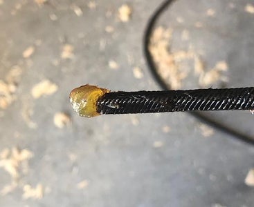

I have a piece of clear plastic tubing with an internal diameter of 3/8 inch. I removed the nozzle from a small grease gun I have and slipped the tubing onto the gun’s tube. The open end fits over the fitting for the square socket in the head that receives the driveshaft, although just a little loosely. If I hold the plastic tubing firmly I can pump grease into the square shaft socket. Choose a grease that is about the same consistency as the factory grease in the head. When I add grease this way, I know when the head is full because old darker grease begins to ooze out of the head inside the mounting collar. See the Update in Step 6, though.

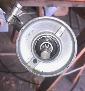

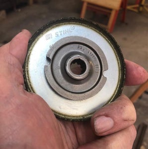

Assembly is mostly the reverse of disassembly. The photo shows the steel flange that goes onto the splined shaft before the string head. The side shown goes on toward the gearhead and away from the string head.

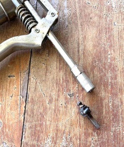

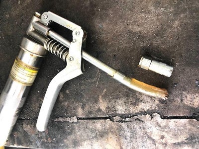

Slipping a clear plastic tube onto the metal tube of a grease gun in Step 4 has worked acceptably well, but I thought of an improvement. I wanted to attach a square piece of steel into the socket for the flexible drive shaft and pump grease through a hole down its center. I had a grease fitting or Zerk, and discovered the threads on it are 1/4 x 28. I found a 1/4 inch bolt and nut with 28 threads per inch in my bolt collection. I drilled a 3/32 inch hole down the center of the 1/4 inch bolt and cut it to about 1 1/8 inches in length. I filed four flat surfaces on the bolt to leave a square shaft 0.200 inch thick. (That is the thickness of the square shank on the end of the flexible drive shaft.) I aligned the hex nut and the hex head and pressed them together as best I could. Then I welded them together. When the weld has cooled screw the Zerk firmly into the 1/4 x 28 nut. My fitting works quite well for inserting grease into the head of the trimmer and is a bit less messy than the plastic tube in Step 4.
