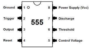

  3. Add power and ground connections for the 555 timer. Pin 8 goes to power and pin 1 goes to ground.
  4. Add a wire connecting pin 2 to 6. Follow up with a wire connecting pin 4 to 8. The 2 wires should form an "X" shape over the 555 timer.
  5. Add a 15 µF capacitor connected to pins 1 and 2, with the negative side of the capacitor on pin 1.
  6. Add a 1.2kΩ resistor connecting pins 7 and 8. Follow up with a 47kΩ resistor connecting pins 6 and 7.

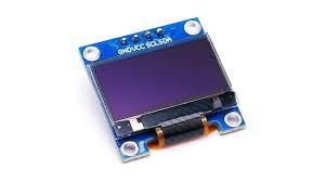

  1. Place the OLED screen on the breadboard. Try to center it in the middle of the line chaser as best as possible.
  2. Make a note of the 4 holes the OLED screen sits on, as the power and ground wires go underneath it.
  3. Once noted down, remove the OLED screen from the breadboard and add a ground wire on the leftmost hole. Add a power wire 1 hole to the right of the ground wire.
  4. Place the OLED screen back on the breadboard. Locate the holes for the SCL and SDA. They should be labelled on the OLED screen.
  5. Wire the SCL to pin A5 on the Arduino, and the SDA to pin A4.
