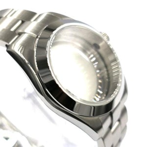

  13. 40mm (inner diameter) Stainless Steel Watch Case (Aliexpress)

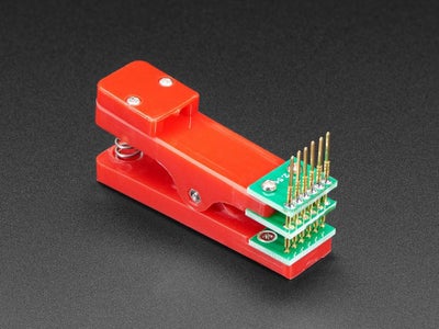

  1. Pogo Pin Probe Clip - 6 Pins with 2.54mm Pitch (Aliexpress)

🔹 Programming Interface
To program the ATmega328P directly on the board, I included a 6-pin gold-plated programming pad on the PCB’s bottom side.
The pins are arranged in a 2.54 mm spaced row with the following connections:
  1. MISO
  2. MOSI
  3. SCK
  4. RST
  5. GND
  6. VCC
Instead of using a bulky header, these pads are designed for a pogo pin clip, allowing quick and reliable connections for uploading code or updating firmware without affecting the watch’s compact form factor.

Then I connected a pogo pin programming clip to the gold pads on the bottom side of the board to upload the firmware. The watch powered up immediately, and all 72 LEDs lit up beautifully in the expected pattern.

For quick connection, I used a magnetic pogo pin clip, which securely touches the gold pads and allows hassle-free uploading — no soldering or plugging required.

LumiDial board has six gold-plated pads for SPI programming. Use the pogo-pin adapter to connect them to the Arduino UNO as follows:

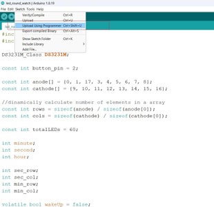

🔹 Uploading the Code
Now you’re ready to flash your LumiDial code:
  1. Hold Shift and click the Upload button
  2. (or choose Sketch → Upload Using Programmer)
  3. Wait until you see “Done Uploading” in the IDE.
That’s it! Your LumiDial watch firmware is now programmed directly into the ATmega328P.
If everything is connected properly, the sketch will upload in a few seconds. Once done, the watch will automatically start running, displaying time using the red and blue LEDs.

🧠 Power Optimization Update
In the first version of the LumiDial wristwatch, the ATmega328P microcontroller was running at 16 MHz using an external crystal, which allowed the watch to operate for around 30 hours on a full charge. However, for a wristwatch that continuously drives LEDs and reads time from the RTC, power efficiency is critical. To extend the battery life, I re-optimized the firmware and hardware configuration. The system clock was reduced from 16 MHz external to 2 MHz internal, which immediately lowered the overall current consumption of the microcontroller. In addition, I turned off all unused peripherals—such as the ADC, UART, SPI (used only during programming), and extra timers—by configuring the Power Reduction Register. This approach kept only the I²C interface active for RTC communication and the digital I/O pins for LED control. With these optimizations, the LumiDial consumes significantly less power, resulting in a much longer runtime per charge without affecting its timekeeping accuracy or LED animation performance.
Following is my optimized code:

Step 6: Assembly in Watch Case
Instead of using a 3D-printed enclosure, I chose a ready-made stainless steel wristwatch case for assembling the LumiDial circuit.
This gives the project a premium and durable finish, just like a commercial smartwatch, while maintaining the handmade DIY spirit.
🔹 Choosing the Watch Case
To fit the LumiDial PCB perfectly, the inner diameter of the watch dial must be exactly 40 mm.
This dimension matches the circular PCB design — the board sits snugly inside the case without any gaps or need for additional spacers.
A stainless steel case not only looks elegant but also provides good mechanical strength and heat resistance during soldering.
It also enhances the overall visual appeal, complementing the gold-finished PCB and glowing LED dial beautifully.
🔹 Placing the PCB
After testing and calibration, I carefully placed the assembled PCB inside the 40 mm stainless steel watch case.
Make sure the LED side faces outward, properly aligned with the glass window of the case so that the LED rings are centered and evenly visible from the front.
The fit should be tight enough that the PCB stays in place without wobbling. If needed, a thin rubber or plastic ring can be used as an insulator between the PCB edge and the metal body.
