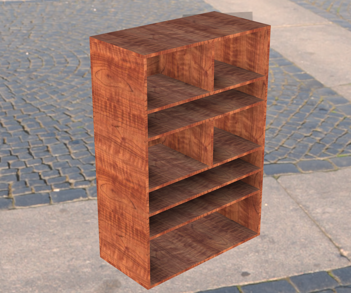

Step 12: Side Face Assembly
We create another file and save it, in this case we don't need to create a new sketch, we just bring the files we have worked on; we go to the "Base Face" file and right click "Insert in current design".
Then we do the same with the "Side Face" file and we position it on the right side of the "Base Face", we approach the intersection and we give the option to "Assemble"; we choose "Union" or we can also press the J button.
In this case we will only work with edges and with the cursor we position ourselves in the middle of the external edge of the "Side Face" and we will join it with the middle of the external edge of the "Base Face". And this is how the assembly will be carried out.
Step 13: Side Face Assembly (2)
Insert the "Side Face" again and position it this time on the left side of the "Base Face", approach the intersection and click on the "Assemble" option; choose "Union".
With the cursor we position ourselves in the middle of the external edge of the "Side Face" and we will join it with the middle of the external edge of the "Base Face". And this is how the assembly will be carried out.
Step 14: Rear Face Assembly
Insert the "Back Face" and position it well, approach the intersection and give the option "Assemble"; choose "Union".
With the cursor we position ourselves in the middle of the internal edge of the "Back Face" and we will join it with the middle of the external edge of the "Side Face". And this is how the assembly will be done.
Step 15: Top Face Assembly
Insert the “Top Face" and position it well, approach the intersection and click on the "Assemble" option; choose "Union".
With the cursor we position ourselves in the middle of the internal edge of the “Top Face" and we will join it with the middle of the external edge of the "Side Face". And this is how the assembly will be carried out.
Step 16: Front Face Assembly 2
We insert the "Front Face 2" and position it well on the back, this time we tilt it -10 mm, we approach the intersection and we give the option "Assemble"; we choose "Union".
With the cursor we position ourselves in the middle of the internal edge of the "Front Face 2" and we will join it with the middle of the external edge of the "Side Face". And this is how the assembly will be done.
Step 17: Front Face Assembly
Insert the "Front Face" and position it well, tilt it -10 mm as we did with the "Front Face 2", approach the intersection and give the option "Assemble"; choose "Union".
With the cursor we position ourselves in the middle of the internal edge of the "Front Face" and we will join it with the middle of the external edge of the "Side Face". And this is how the assembly will be done.
Step 18: Assembly Face Design
We insert the "Design Face" and this is the only file that we are not going to assemble, we are only going to position it, we incline it -10 mm and we will make it fit right into the groove. So that the joints are not visible we just remove the "Joints" display and that's it, we are done with our Luminous Sign.
